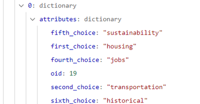

MatthewBrandt
@KenBuja Thank you for your help on this! I was wondering if you had any insights in the second part of the code I am working on to get the desired result table from my initial post. My code below returns a dictionary counting the occurrences of the respective values across the whole dataset, I would instead like a table with the unique counts for occurrences within the specific fields. I imagine I will have to change the value_counts dictionary to include a sub-dictionary or list within each of the values, and then somehow populate that within the loop for each i in fields?
//create dictionary of possible values setting default count at 0
var value_counts = {
    "transportation": 0,
    "jobs": 0,
    "housing":0,
    "sustainability":0,
    "historical":0,
    "parks":0
//list of unique fields to get counts for each of the values
var fields = ["first_choice", "second_choice", "third_choice","fourth_choice","fifth_choice","sixth_choice"]
//loop through rows in feature that contain the text 1st, 2nd, 3rd choice etc.
for(var a in fs_dict) {
    //loop through each field that needs to be counted within that feature
    for(var i in fields) {
        var value = a[fields[i]]
        //add 1 to value counts for each time the feature exists??
        if(IsEmpty(value)) { continue }
        if(!HasKey(value_counts, value)) { value_counts[value] = 0 }
        value_counts[value] = value_counts[value] + 1
var out_fs = {
    geometryType: "",
    fields: [
        {name: "Choice", type: "esriFieldTypeString"},
        {name: "Count", type: "esriFieldTypeInteger"},
    features: []
//return a dictionary of each possible value with their respective count
for(var v in value_counts) {
    var c = value_counts[v]
    var m = {attributes: {Choice: v, Count: c}}
    Push(out_fs.features, m)
return out_fs
return Featureset(Text(out_fs))

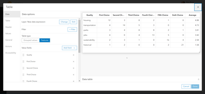

MatthewBrandt
Yes! Thank you. This is exactly what I was looking for. In case you were curious, I also was looking for a weighted "average" to compare the ranks which I was able to successfully do by appending this last bit of code. This returns the same results as the Analyze tab in Survey123 which is what I was trying to replicate.
// Reference layer using the FeatureSetByPortalItem() function.
var fs = FeatureSetByPortalItem(Portal('https://www.arcgis.com'), '2284118eba59466e9169133c458ef9d4' , 0, ['development_priorities'], false);
var choicesArray = []
//return fs
// Split comma separated hazard types and store in array.
for (var f in fs) {
    var split_array = Split(f["development_priorities"], ',');
    var choiceArray = []
    for (var index in split_array) push(choiceArray, split_array[index]);
    push(choicesArray, choiceArray); //add this to final array
//return choicesArray
//Dictionary of rank counts for each choice
// NEW Add Average to each array
    "transportation": {'First Choice': 0,'Second Choice' : 0,'Third Choice' : 0,'Fourth Choice' : 0,'Fifth Choice' : 0,'Sixth Choice' : 0,'Average' : 0},
    "jobs": {'First Choice': 0,'Second Choice' : 0,'Third Choice' : 0,'Fourth Choice' : 0,'Fifth Choice' : 0,'Sixth Choice' : 0,'Average': 0},
    "housing": {'First Choice': 0,'Second Choice' : 0,'Third Choice' : 0,'Fourth Choice' : 0,'Fifth Choice' : 0,'Sixth Choice' : 0,'Average':0},
    "sustainability": {'First Choice': 0,'Second Choice' : 0,'Third Choice' : 0,'Fourth Choice' : 0,'Fifth Choice' : 0,'Sixth Choice' : 0,'Average':0},
    "historical": {'First Choice': 0,'Second Choice' : 0,'Third Choice' : 0,'Fourth Choice' : 0,'Fifth Choice' : 0,'Sixth Choice' : 0,'Average':0},

KenBuja
MVP Esteemed Contributor
This code works
    "transportation": {'First Choice': 0,'Second Choice' : 0,'Third Choice' : 0,'Fourth Choice' : 0,'Fifth Choice' : 0,'Sixth Choice' : 0},
    "jobs": {'First Choice': 0,'Second Choice' : 0,'Third Choice' : 0,'Fourth Choice' : 0,'Fifth Choice' : 0,'Sixth Choice' : 0},
    "housing": {'First Choice': 0,'Second Choice' : 0,'Third Choice' : 0,'Fourth Choice' : 0,'Fifth Choice' : 0,'Sixth Choice' : 0},
    "sustainability": {'First Choice': 0,'Second Choice' : 0,'Third Choice' : 0,'Fourth Choice' : 0,'Fifth Choice' : 0,'Sixth Choice' : 0},
    "historical": {'First Choice': 0,'Second Choice' : 0,'Third Choice' : 0,'Fourth Choice' : 0,'Fifth Choice' : 0,'Sixth Choice' : 0},
    "parks": {'First Choice': 0,'Second Choice' : 0,'Third Choice' : 0,'Fourth Choice' : 0,'Fifth Choice' : 0,'Sixth Choice' : 0}
for (var f in fs) {
    for(var i in choiceArray) {
        var value = choiceArray[i]
          //if(!HasKey(value_counts, value)) { value_counts[value][i] = 0 } ignoring non-present values for now
          //console(value, i, value_counts)
        if (i == 0) value_counts[value]['First Choice'] = value_counts[value]['First Choice'] + 1
        if (i == 1) value_counts[value]['Second Choice'] = value_counts[value]['Second Choice'] + 1
        if (i == 2) value_counts[value]['Third Choice'] = value_counts[value]['Third Choice'] + 1
        if (i == 3) value_counts[value]['Fourth Choice'] = value_counts[value]['Fourth Choice'] + 1
        if (i == 4) value_counts[value]['Fifth Choice'] = value_counts[value]['Fifth Choice'] + 1
        if (i == 5) value_counts[value]['Sixth Choice'] = value_counts[value]['Sixth Choice'] + 1
for (var a in value_counts) {
    value_counts[a]['Average']=(value_counts[a]['First Choice']*6+value_counts[a]['Second Choice']*5+value_counts[a]['Third Choice']*4+value_counts[a]['Fourth Choice']*3+value_counts[a]['Fifth Choice']*2+value_counts[a]['Sixth Choice'])/Count(fs)
var Dict = {
  'fields': [
   { 'name': 'Quality', 'type': 'esriFieldTypeString' },
   { 'name': 'Average','type': 'esriFieldTypeDouble'},
   { 'name': 'First Choice','type': 'esriFieldTypeInteger'},
   { 'name': 'Second Choice','type': 'esriFieldTypeInteger'},
   { 'name': 'Third Choice','type': 'esriFieldTypeInteger'},
   { 'name': 'Fourth Choice','type': 'esriFieldTypeInteger'},
   { 'name': 'Fifth Choice','type': 'esriFieldTypeInteger'},
   { 'name': 'Sixth Choice','type': 'esriFieldTypeInteger'}],
 'geometryType': '',
 'features': []};
var index = 0
for (var value in value_counts){
  Dict.features[index] = {
    'attributes': {
      'Quality': value,
      'First Choice': value_counts[value]['First Choice'],
      'Second Choice': value_counts[value]['Second Choice'],
      'Third Choice': value_counts[value]['Third Choice'],
      'Fourth Choice': value_counts[value]['Fourth Choice'],
      'Fifth Choice': value_counts[value]['Fifth Choice'],
      'Sixth Choice': value_counts[value]['Sixth Choice'],
      'Average': value_counts[value]['Average']
  index++;
return FeatureSet(Dict);
