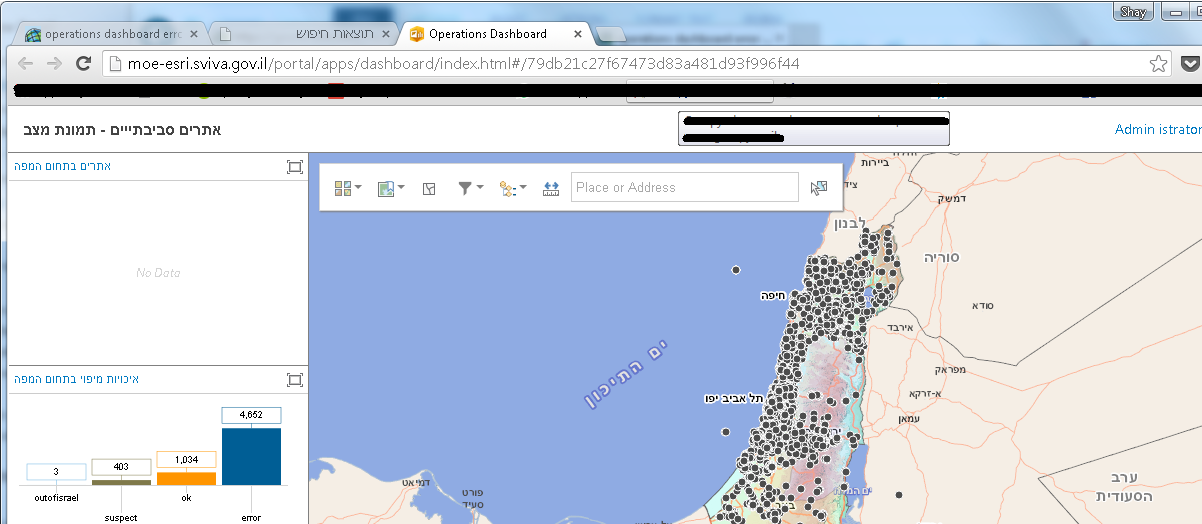

Here's another simulation.. A picture of the dashboard (in the browser) when I'm connected as a user
And here is the exact same app when I disconnect and surf anonymously

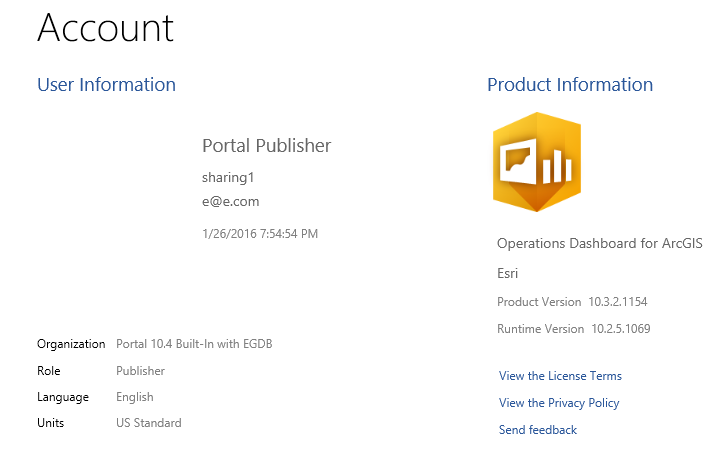

What version of dashboard is this?  Can you send a screenshot of the Account screen?
I'm using the 10.4 version here:
