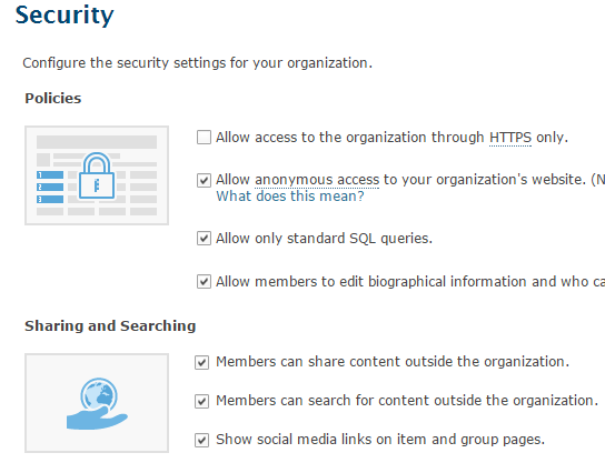

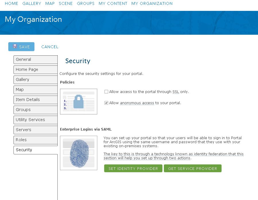

Does the webmap work with anonymous access?
Do you have anonymous access checked in your org settings under Security? (you will need to be logged in as admin)
SvivaManager
Yes I have anonymous access enabled. Your settings window looks completely different from ours
