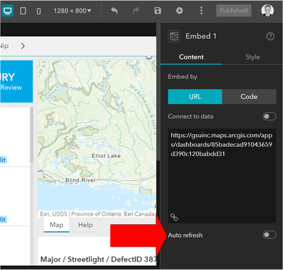

PaulGiroux1
I have a dashboard on a page and have the Embed "Auto refresh" off and it seems to do the trick.

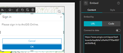

JanetBrewster1
Paul,
When I try to embed an existing Dashboard, it says it wants me to sign in to AGOL. I don't understand...I am signed in -- the Experience and the Dashboard are both in my account. Any thoughts? Thank you!
