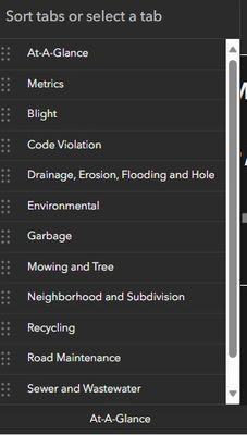

Thank you so much @zooapk for your reply, but I didn't find how to add pages "see in the below screen shot" its tab for each page when you click on each one you will go to that page, but I can't find how to add tab/pages... Screenshot 2023-09-25 154058.jpgScreenshot 2023-09-25 154058.jpg
JenniferAcunto
The "pages" are really grouped elements stacked on top of one another. Add all of the elements you want for  your first page and group them together. Then add all of your elements for the second page and group them together. Drag your second group onto your first group and stack them. Repeat for each additional page.
Dashboard Layouts
- Jen
NasratullahOmari
Thank you so much @JenniferAcunto, this is what I was looking for😉
