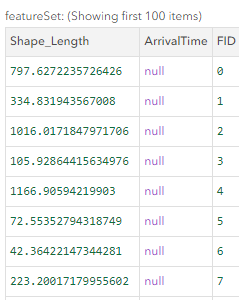

My problem is that I have a value, called "ArrivalTime" (which is a number) that some layers have, and others don't. When I execute the code, the layers that do not have an "ArrivalTime" show this value as "null" and I cannot filter based on it, they just get excluded automatically.
My question is, I'd like to replace this "null" value by a 0, so that I can filter on them the same as the layers that do have an "ArrivalTime" value.

Here is an example of the return table that I get.

The dictionary contained the field "ArrivalTime" but you were assigning 0 to "Arrival_Time".

Oh right it works now,
Thank you so much !! Why couldn't I have seen that earlier,
