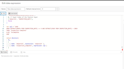

Hi Josh,
Aplogies for my delayed response. Thank you so much for helping me with this. I've given it a go when adding a table but I get this error: Test execution error: ',' expected.. Verify test data.
I can't figure out where the missing ',' should go
jcarlson
MVP Alum
Based on your screenshot, it looks like the closing parenthesis is missing from Distinct.
