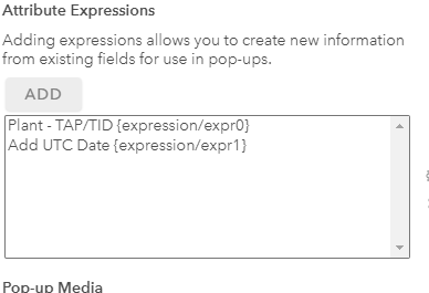

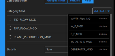

Is it possible to have a attribute expression show up as a field in dashboard?
I added two attribute expressions in the webmap popup and I cannot find them in the dashboard.

The dashboard is accessing the data table directly, and does not "see" attribute expressions defined in the map or layer visualization settings. If it's not a true field, you can't use it.
You *can* use Data Expressions in Dashboards, which is one way of "baking in" Arcade expressions.
