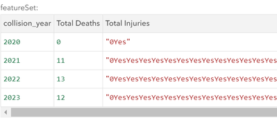

Really close Ken, output is not counting the injuries though, looks like this.
gis_incapacitating is a string field (Yes or No) and needs to be counted for 'Yes' records and then summed
Current expression iteration for reference:
