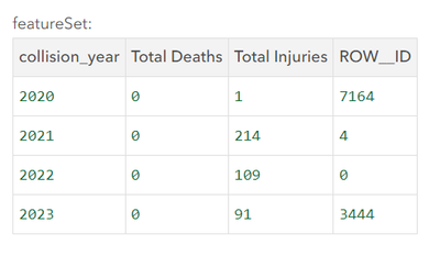

Produces this output:
Number of deaths should not be zero
KenBuja
MVP Esteemed Contributor
I'm definitely not reading things closely enough! Just the injury field is Yes/No, so replace line 23 with
attrs['fatal'] = f.number_dead;
RichardCreek
Ken, you have been an amazing help, I really appreciate it.
