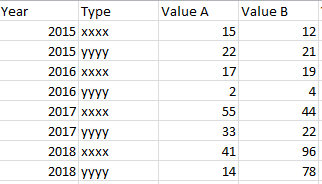

Here is my table as a starter. (attachment 1.PNG)
One set of values per year and per type.

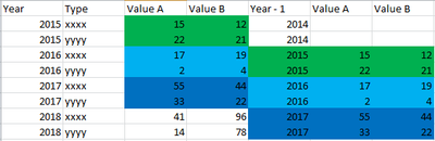

and this is what I'm looking for as a result (attachement2.PNG)
New fields with values already present in the table
