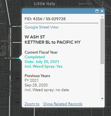

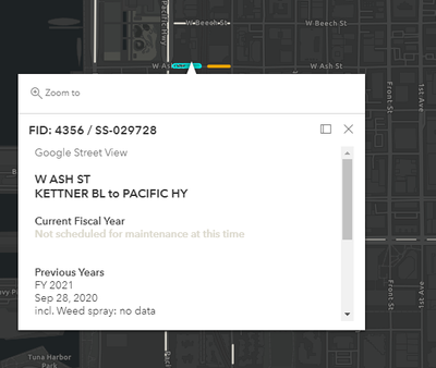

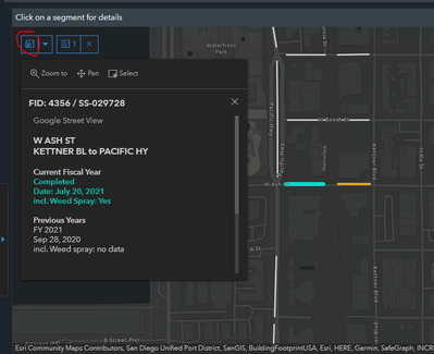

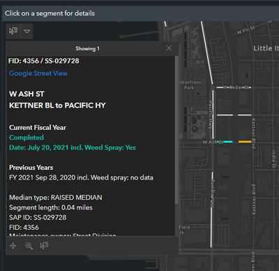

Hi @WestervilleGIS and @SandraLuken1, I am experiencing this as well. I have a few combo Arcade/HTML expressions that populate the pop-up text as Teal or Orange corresponding to status, and then showing the details if they exist.
Classic Dashboards (/apps/dashboards/):
"New" Dashboards (/apps/opsdashboard/):
I see the same behavior in the new Map Viewer:
Map Viewer Classic:
Classic Dashboards works as expected (since TextFormatting.NewLine not supported in JS 3.x apps)

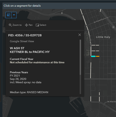

New Dashboard and New Map Viewer, it ignores the calculations and returns the default "Else" instead of the calculation. Some of the calculations use FeatureSetBy functions, but others are fairly simple, like the primary example above:
if ( DomainName($feature,"Maint_Status") == 'Scheduled') {
return "Scheduled"
else if ( DomainName($feature,"Maint_Status") == 'Completed') {
return "Completed"
else  {
return "Not scheduled for maintenance at this time"
Interestingly, if I use the "Select" tool first to click a feature in the New Dashboard, and then click out of the Select tool, the pop-ups then begin working as expected. But I can't ask my users to remember to do this.
