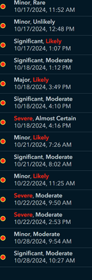

So i have three attributes in the list, "severity", "probability" and date. I would like to show severity in red when its value is "Severe" and probability red as well when its value is "Likely". Second, i wouldn't like the date to have any color change.
I know i have to use HTML source formatting in conjunction with Arcade for this purpose. How can I do this?
Bonus question: How can i please add a calendar icon next to the date? Please note that the date is in the second line
Current output:
Thank you 🙂

Hi Jen, that worked cheers 🙂 🎉
now how can i please add a clock or calendar icon/emoji next to the date and time field value?

Just add the emoji in the line item template next to your field: {field/date_and_time} :alarm_clock:
- Jen
Ed_
by MVP Regular Contributor
yup that worked like a charm thank you so much for your time and help @JenniferAcunto  🙂
