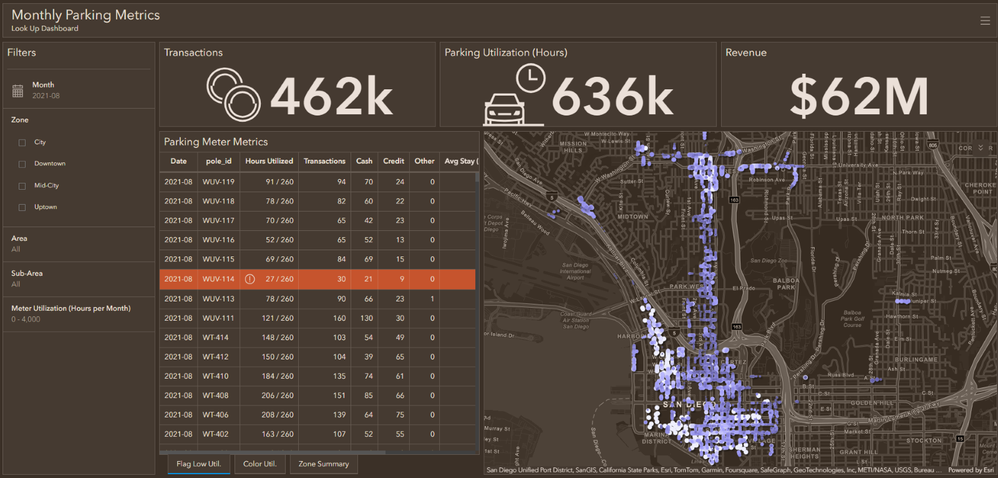

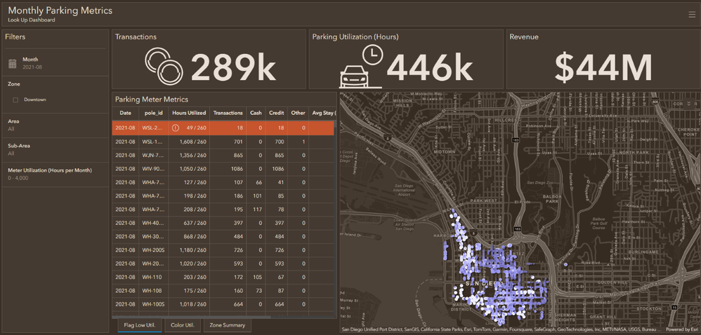

Say I have this Parking Dashboard with a normal dashboard URL (hxxps://sampleorg/apps/dashboards/12d1b1dbee3d44eab40e441164f356bf). By default, it displays several different zones.
Parking dashboard covering various zones.Parking dashboard covering various zones.

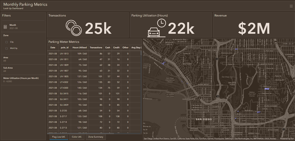

I might have different teams for each zone, and while they can easily filter the dashboard for their zone, they don’t want to. They want a dashboard that just opens to their zone automatically. Instead of having to make multiple versions of the same dashboard, I can instead set up a URL parameter to filter the zones and give each team their own unique link.
This link will open displaying only Downtown: hxxps://sampleorg/apps/dashboards/12d1b1dbee3d44eab40e441164f356bf#p1=Downtown
Parking dashboard displaying the Downtown zone.Parking dashboard displaying the Downtown zone.
And this link will open City and Mid-City zones: hxxps://sampleorg/apps/dashboards/12d1b1dbee3d44eab40e441164f356bf#p1= City,Mid-City
Parking dashboard displaying City and Mid-City zones.Parking dashboard displaying City and Mid-City zones.

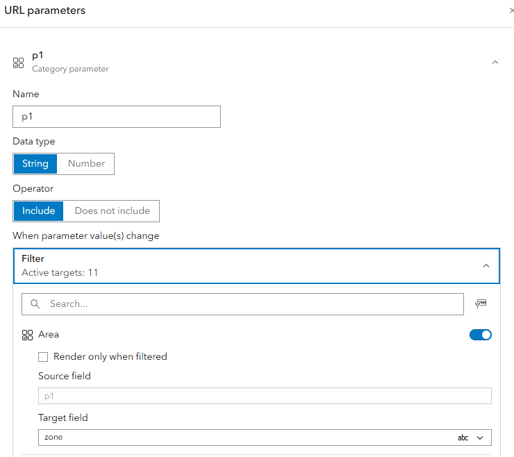

Click on the + Add URL parameter button and select the parameter type you want to add.
Add URL Parameter ButtonAdd URL Parameter Button
You can use the default parameter name or set your own. I typically just use the default unless I am adding quite a few and then I will set the name, so it is easier to remember which is which. The name is used in the URL so be sure to name it something short and to the point.
Parameter NameParameter Name
The remaining configuration options available to you will depend on the parameter type, but the basic steps are just like setting up Dashboard Actions.
URL Parameter ConfigurationURL Parameter Configuration
Once you are done configuring your parameters be sure to save your dashboard.

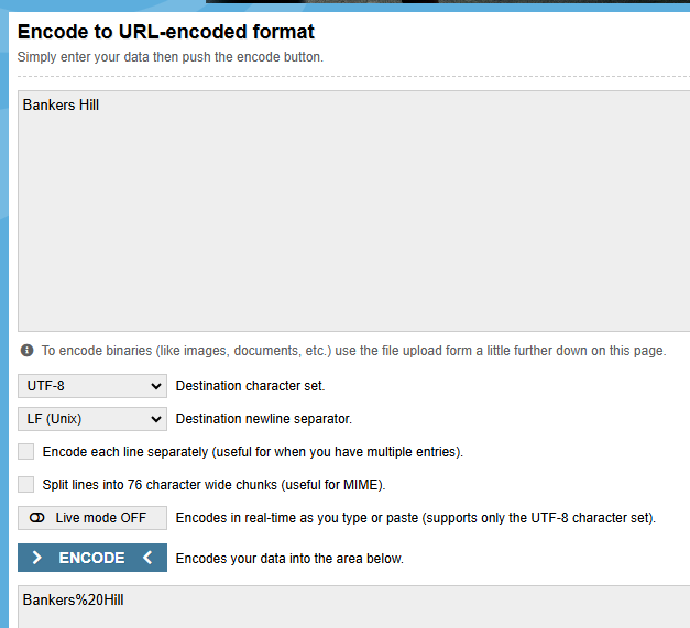

If your value has spaces or special characters in it, you must encode it. Do not encode the entire URL, ONLY encode the specific value.
hxxps://sampleorg/apps/dashboards/12d1b1dbee3d44eab40e441164f356bf#p1= Bankers%20Hill
You can use this handy encoder for reference.
URL Encoder ToolURL Encoder Tool

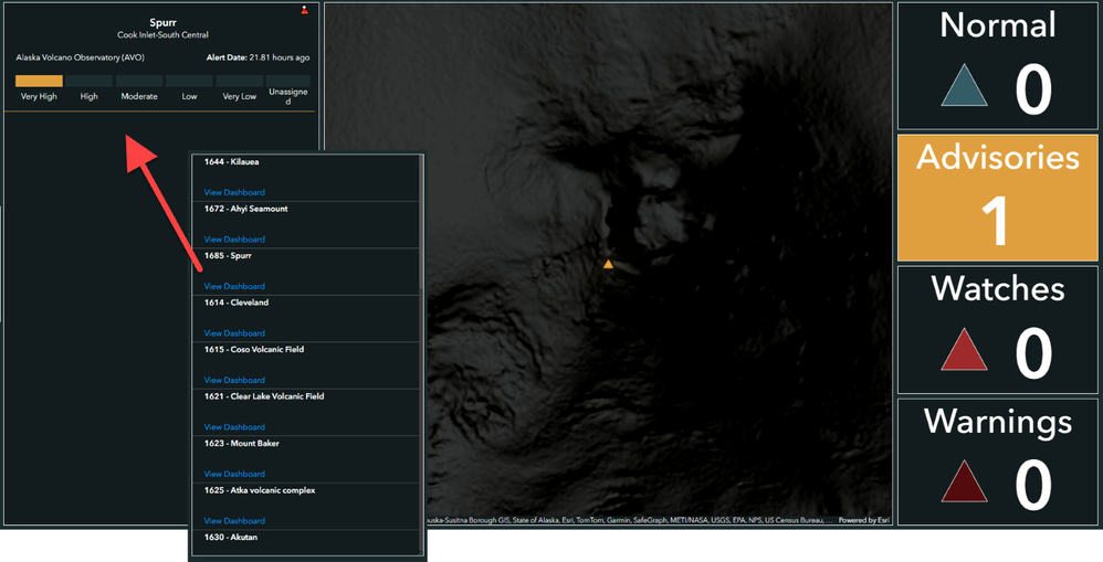

You can set up dynamic URLs that are automatically created for you using pop-ups or a list. I’ll use a dashboard list element, but the basic approach works in pop-ups and other apps.

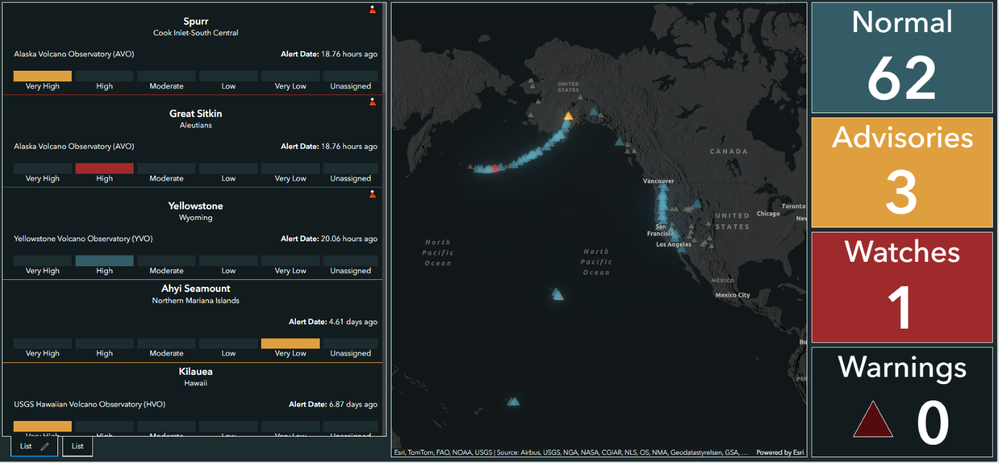

I have this default dashboard that displays volcanoes.
Global Volcano DashboardGlobal Volcano Dashboard
I am going to add a hyperlink to this dashboard in a separate dashboard list item that will use dynamic URL parameters to open this dashboard focused on the specific volcano the user selected in the list.
List to Filtered DashboardList to Filtered Dashboard

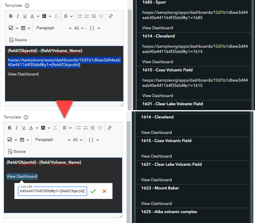

Method 1
This is the most straightforward method, but it only works if you do not need to encode any of your parameter values.

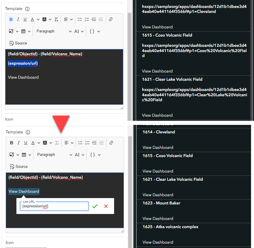

Simply copy and paste your dashboard URL (with parameters but not the parameter values) into the rich text editor.
Then use the field picker to add the field that is used as the URL parameter value to the end of your URL.
Now we have the constructed URL that is unique to each list row, but it is ugly. Time to turn it into a hyperlink.
Add your hyperlink text to the rich text editor.
Highlight the link you just created and cut it.
Highlight your hyperlink text and click on the Link button.
Paste the cut URL into the Link URL box.
Link Creation to HyperlinkLink Creation to Hyperlink
