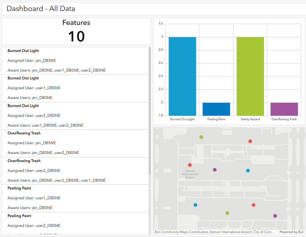

Let’s start by examining a dashboard that is not filtering by the current user. This dashboard is simple and contains 10 features.
Starting Dashboard with 10 FeaturesStarting Dashboard with 10 Features

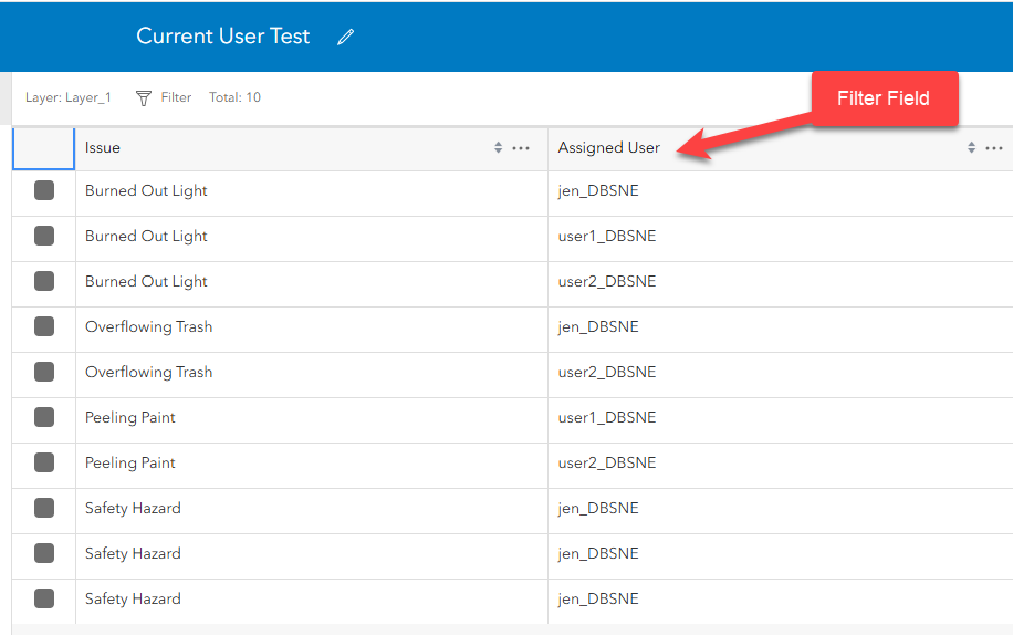

Requirements: A field in your dataset containing the username you want to filter data by.
Assigned User FieldAssigned User Field

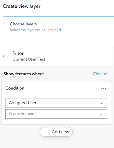

Expand the Layer definitions section and add a filter.
Select the field that contains the username you will be filtering by and change the operator to ‘is current user’.
View Layer DefinitionView Layer Definition
Finish creating the view.

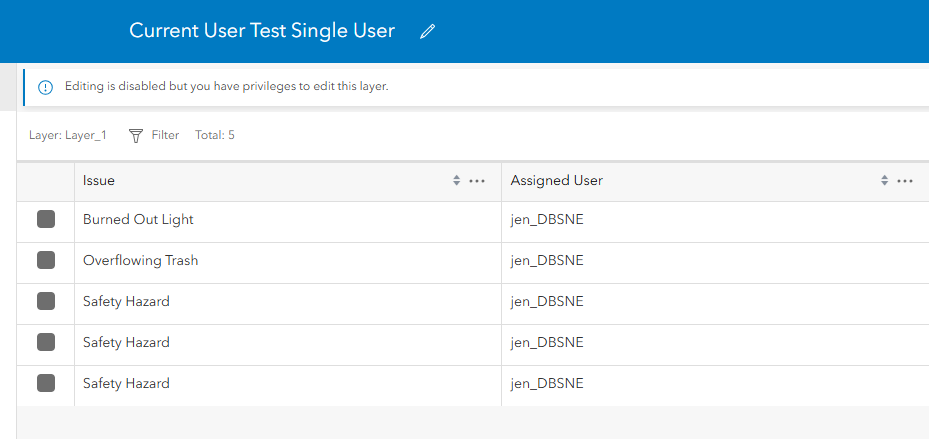

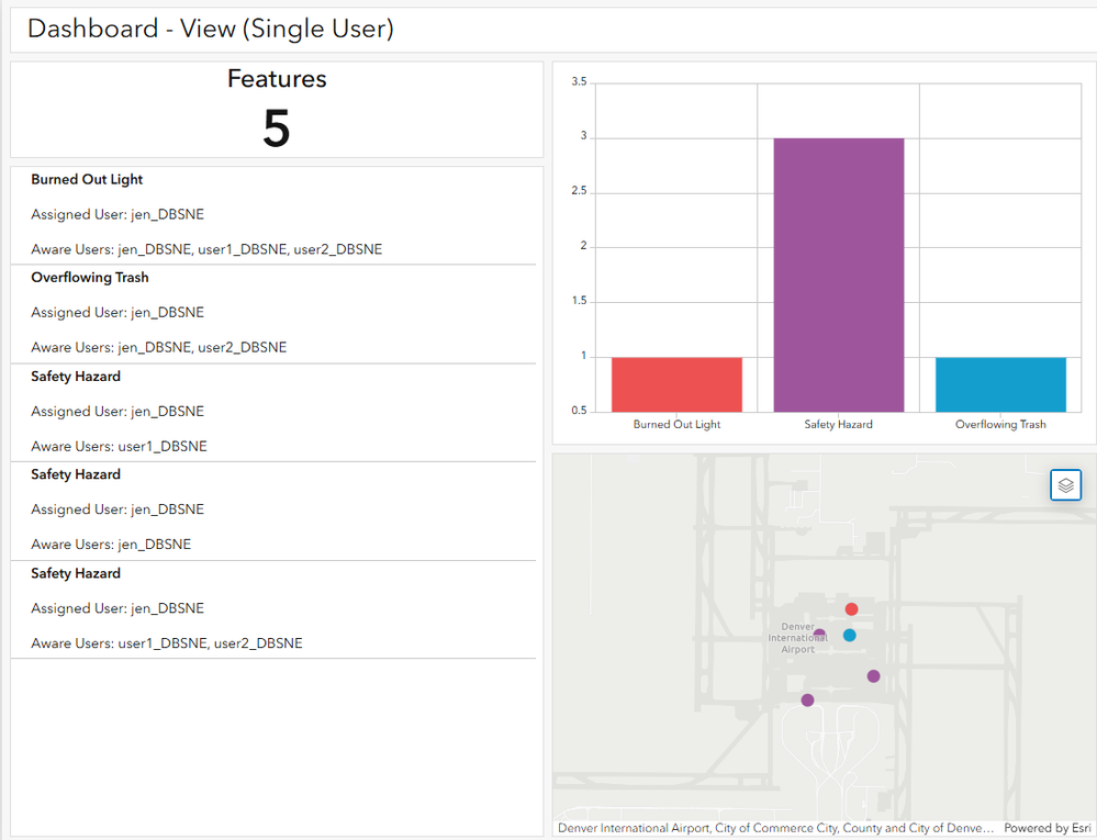

Let’s look at our resulting data.
Layer with 5 features - all assigned to meLayer with 5 features - all assigned to me
I can only see records that I am assigned to. If another user was to look at this view, they would only see the records that are assigned to them.
This new view layer will be used to create our dashboard.
Dashboard with 5 featuresDashboard with 5 features

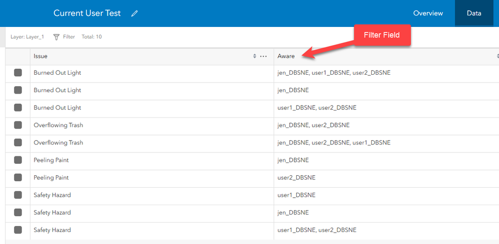

Requirements: A field containing a comma separated list of usernames to filter.

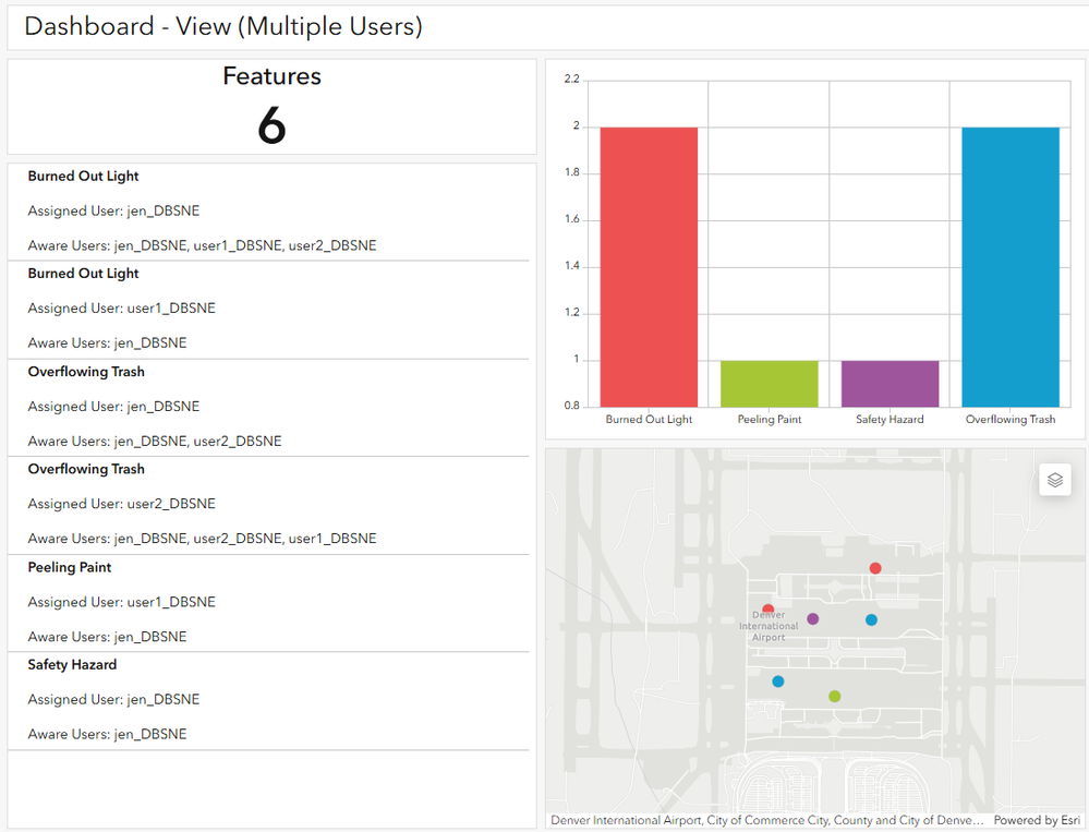

Field with comma separated users.Field with comma separated users.
My fabulous colleague @PaytenJarnagin has already outlined all the steps, so I won’t rehash them here. Go check out Display Features Relevant to the Current User for step by step instructions.
Here is the result of the view.
Layer with 6 features - all of which include my username.Layer with 6 features - all of which include my username.
Again, we can use this new view layer as our dashboard source.
Filtered dashboard with 6 features.Filtered dashboard with 6 features.

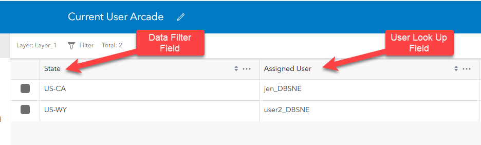

The wildfire layer contains a field indicating the Point of Origin State. I’m going to create a look up table that assigns users to a specific Point of Origin state.
Look up table with the assigned username and assigned state.Look up table with the assigned username and assigned state.
The state value is going to be used to filter the wildfire data, so it must match the values in the Current Wildfire layer. The assigned user field will include the username of the person assigned to that state.

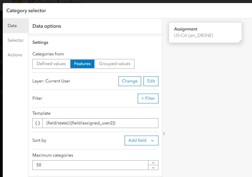

In my dashboard, I’m going to add a Category Selector that uses Categories from Features.
The data source will be a Data Expression that filters my look-up table based on the current user.
// Look Up Table
var fset_incidents = FeatureSetByPortalItem(
                          Portal("https://www.arcgis.com"),
                          '4ec710cb554d40999d240bc39a04c9b0',
var username = GetUser()['username']
return Filter(fset_incidents, `assigned_user = '${username}'`)
I’m including both the state and user in my template, but you can use whatever makes sense for your use case.

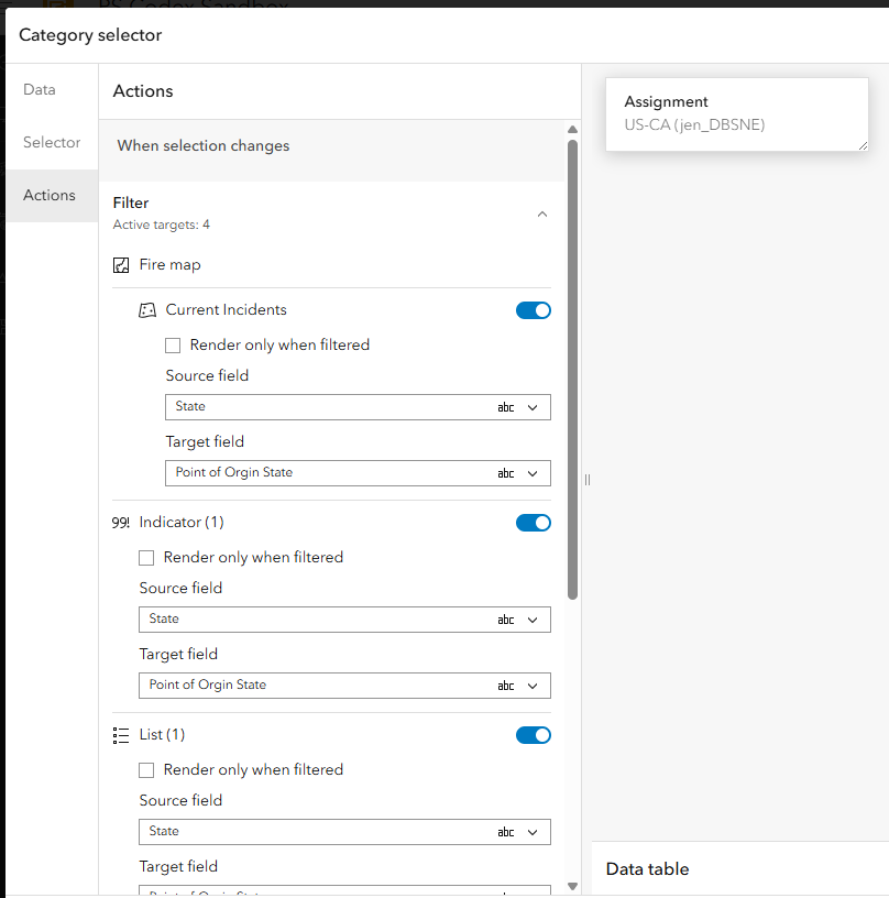

Category Selector ConfigurationCategory Selector Configuration
Make sure you do NOT enable the ‘None option’ for your selector.
Finally, I will set it to filter all of my dashboard elements based on the State field.
Category Selector ActionsCategory Selector Actions

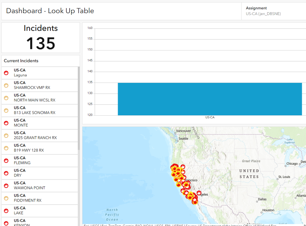

Here is the final dashboard.
Wildfire dashboard showing only California wildfires.Wildfire dashboard showing only California wildfires.
