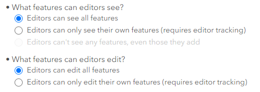

Hosted feature service settings enable the item owner to control who can see and edit features through the settings shown below. It’s very common that users need to see or edit more than “their own” but less than “all features”. For example, in a statewide dataset, a user from County A may need to see and edit all features associated with County A.

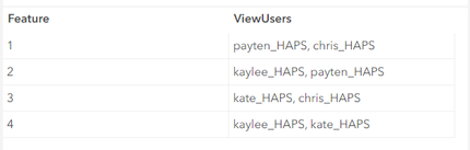

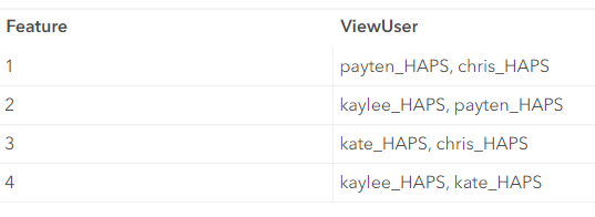

  1. Make sure your hosted feature layer has a field with a comma separated list of usernames for users who should have access to each record, like this example:

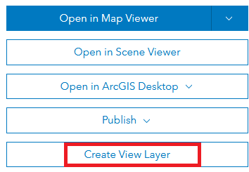

  2. In ArcGIS Online, navigate to your hosted feature service Item Details and click Create View Layer then follow the instructions here.

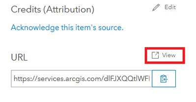

  3. Go to the Item Details of the hosted view layer. Scroll down and click View next to the URLPaytenJarnagin_2-1722456219226.png

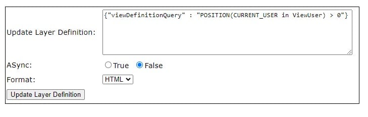

  6. Scroll down to the bottom of the page and click Update DefinitionPaytenJarnagin_5-1722456219227.png
  7. Delete all the JSON in the Update Layer Definition dialog box
  8. Navigate to https://jsonlint.com to help define the JSON object to be passed
  9. Paste the following into the JSON validator, then the Update Layer Definition dialog box:
    {"viewDefinitionQuery" : "POSITION(CURRENT_USER in ViewUser) > 0"}
  10. Replace ViewUser with the field in your data which contains a comma separated list of usernames that should have access to each record, like this example:
  11. Click Update Service Definition.
