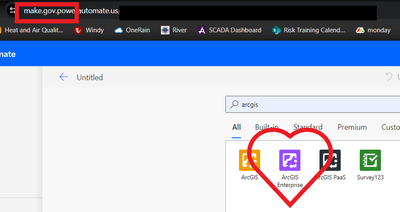

COSPNWGuy
I just randomly checked today, but I am seeing it show up in our gov cloud tenant! However, I am only seeing actions, no triggers available. What do other folks see?
ZachBodenner
MVP Regular Contributor
That's what I'm seeing too. I'm not sure if this is expected though? Maybe it is but there's some other way that these things need to be triggered?
