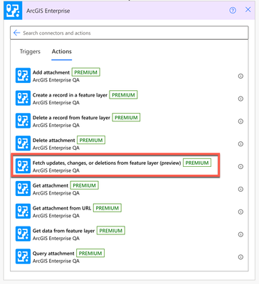

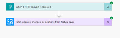

  1. Add a new action and search for the ArcGIS Enterprise connector
  2. Under the list of actions, select Fetch updates, changes, or deletions from feature layer (Preview)

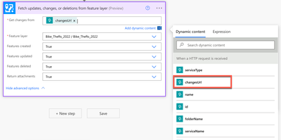

  1. In the Get changes from field, select the chnagesUrl from the dynamic content list

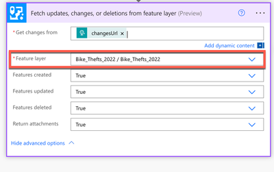

  1. Select the layer that is needed for the webhook flow. This should be the same layer you edited in the first section of this walkthrough.
  1. By default, all the options that can be used as trigger are set to true. You can change these options based on the type of flow you are creating.
  1. Save the flow. After saving, the trigger will autogenerate a URL. This URL is needed for the next steps and configuring the webhook in ArcGIS Enterprise.
  1. After saving, you should have a flow that looks like this:

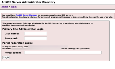

  1. Navigate to the following URL:
    1. https://organization.domain.com/server/admin/login
  2. When the page loads, you should see the following screen:

  1. On the previous page/tab, paste in the newly generated token to the Portal token field
  2. Press Login

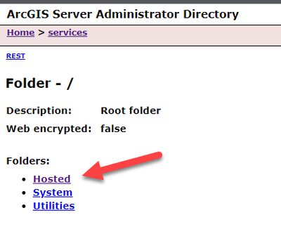

  1. Once logged in, select Services from the list of resources
  1. Select the appropriate folder where the feature layer is stored. By default, this should be under the Hosted category
  1. Select the service you want to add the webhook to

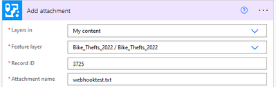

  1. Add a new step and search for the ArcGIS Enterprise connector
  2. Select Add attachment from the list of actions
  1. In the action window, select the layer that contains the webhook

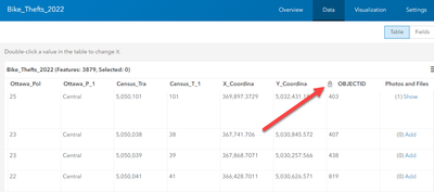

  2. For Record ID, type in an ObjectID or unique identifier from your feature layer. You may need to show this column in your data table
  1. For Attachment name, type in:
    1. webhooktest.txt
  1. For File content, type in:
    1. This is a test.
