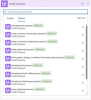

ArcGIS Enterprise
If you had gone to this year's User Conference in San Diego, you might have heard the team mention support for ArcGIS Enterprise inside of Power Automate. Well, it's finally here! We are rolling out the ArcGIS Enterprise connector in phases.
The first phase, which is now available in Power Automate, contains all of the same CRUD-based operations that are found in the ArcGIS connector. For example, you can start adding, deleting, or updating records and attachments in your feature layers just as you would using the ArcGIS connector.
The second phase of the ArcGIS Enterprise connector will contain the remaining actions that pertain to geocoding, geoenrichment, and networking. We are also working on adding webhook support for ArcGIS Enterprise 11.2 and above. In the current phase of the connector, you must manually set up the webhook on your feature layer.
Details on how that is done can be found in here.
Note: This is a preview action as support for webhooks will not be fully integrated until the release of ArcGIS Enterprise 11.2.

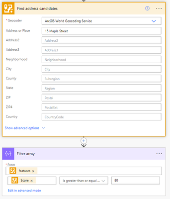

Find Address Candidates
As we have been working through various flows and feedback from you, a common ask was having the ability to use custom geocoders in the geocoding actions, Find Address Candidate and Geocode Addresses. By default, those two actions return the top match from the ArcGIS World Geocoding Service, and you can pass those values into another action or application.

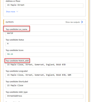

Dynamically, it will only return the top result. For example, when I geocode 15 Maple Street, I receive the best match after the flow has finished. I deliberately did not pass any other information other than the street name. As a fun note, this is one of the most common street addresses in the United States.
In the results, it appears that the World Geocoder gave me a location in England. Even the score that was returned isn't 100 (meaning it wasn't a perfect match).

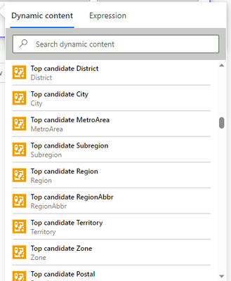

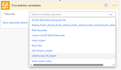

Now let's pass that same variable into the new action Find Address Candidates. The first difference in this action is the ability to change the geocoder. This list is populated dynamically from your ArcGIS Online (and eventually Enterprise) organization. For this example, I will still use the ArcGIS World Geocoding Service.
When I use the same address, the results window looks a bit different. In this result, it is now sorted by the Top candidate

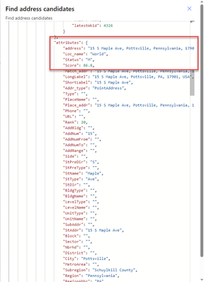

If I peek at the raw outputs, I can see that there are multiple results for this address.
From this action, I can now pass either the top candidate or create a flow that filters out the results based on a score of 80 or above. I encourage you to play around with this action and use it in your flows as it will open up some new possibilities with custom geocoders in your organization.

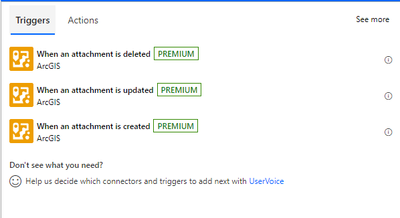

Attachment Triggers
  • When an attachment is created
  • When an attachment is deleted
  • When an attachment is updated

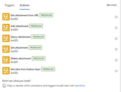

Attachment Actions
  • Add attachment
  • Query attachment
  • Get attachment
  • Delete attachment
  • Get attachment from URL

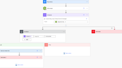

TL2
@erica_poisson
I have a simple flow for both ArcGIS and Survey123 connectors, it runs every hour and alerts me if the connection failed.  I don't trust the token life either.
erica_poisson
@TL2  - could you share a screen capture of this flow? I'd be very interested in setting something similar up. This continues to be a massive pain point of using this technology. I have reminders all over the place to check tokens, but it seems like the length keeps changing!
TL2
Note, it "fails" every time but I make the Terminate to run if it fails and log Successful.  If it's actually successful, it sends the email.

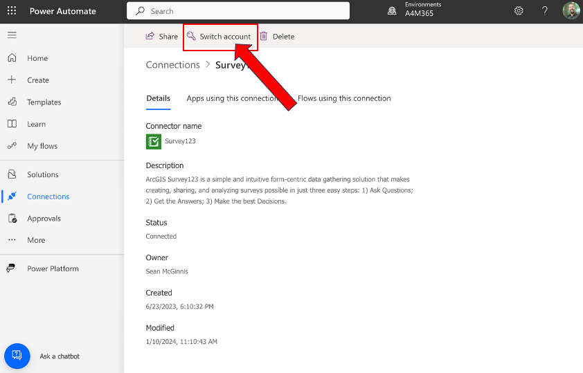

SeanKMcGinnis
Hi @erica_poisson,
Unfortunately, the Survey123 connector is still using the older pattern of authentication. Our team is working with the Survey123 team to update the authentication pattern to the one currently in use by the ArcGIS Connectors for Power Automate. I do not have an estimate time when this will be completed, but when deployed (and promoted to GCC), it will address the timeout issue.
As updating the connection so you no longer have duplicates, I go to the Survey123 Connection and click the 'Switch Account' button and re-enter my credentials. This renews the authentication tokens and prevents creating another connection.
Switch Account process will allow you to reauthenticate the connection and keep all Flows running.Switch Account process will allow you to reauthenticate the connection and keep all Flows running.
