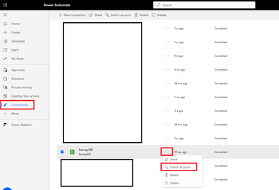

The solution would be every 14 days to refresh the connection, which can be done by going to Connections, hitting the 3 dots next to the Survey123 connection, and hitting Switch account and then just signing back in with the same credentials. No need to create a new connection each time.

Thank you! I'd noticed that Switch Account option, however I wasn't sure exactly what that did or how that would impact my flows.
I just did this, re-ran the failed flow and it worked. Thank you so much! I saw that video, but never watched it and didn't come across this in any of the other posts I read. It sounds like as long as I do this every 14 days I will be OK.
