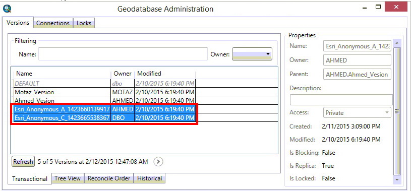

I have a map document that contains a layer from a versioned Enterprise Geodatabase, I published it via ArcGIS Server (the service is synch-enabled), and added the resulted feature service to an ArcGIS Online map to be used by data collectors via the collector app in offline mode.
When a collector starts downloading this map on his device (in the collector app), a new version is created (Esri_Anonymous), and any edits made by this editor are stamped by this “Esri_Anonymous” in the editor-tracking fields!
This is shown with the screenshot below.
How can I make the collector app use the version used while publishing this map or the username of the collector for stamping the edits?

Because you don't have secure rest endpoints. Test this by navigating on your phone to your rest endpoint. If you are presented with a user name and password, you're secure.
Try to hit the service REST endpoint from your phone.
http://yourserver/arcgis/rest/services/folder/service/FeatureServer/1?f=json
Esri Anonymous will appear in a collector application edits because people are signing in on AGOL, and then hitting your service as anonymous. Editor tracking will only work in this instance if you had agol on your network (Portal) or if you have shared a secured service with AGOL, thus requiring the user to input their credentials every time they open the map.
