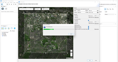

I'm trying to learn to use cityengine, but every time I try to download map data I get a gateway timeout error.

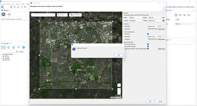

I sign in successfully, the get map data window pops up correctly, I set extent successfully and click okay. The progress bar appears and works through 'downloading elevation data', then stops at 'downloading map' around 1/3 of the way through, before throwing the error 'gateway timeout'.
I tried reinstalling, connecting through a VPN, restarting my PC, but nothing works.
Here's a screenshot of before the error appears, then the error itself:
Please let me know if there's a way to avoid this, hopefully it's just some small detail I missed.

RonBar-Ad
Thanks! Changing both settings to 2k seems to be working consistently

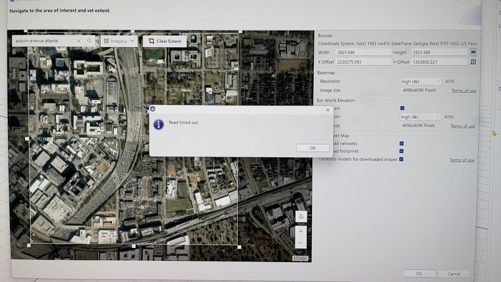

This is still a problem 01/2023, I get "Read Time Out" errors when trying to download the smallest possible map tile in 4K.  It will only download OSM data onto a 2K map.  Is there a fix?IMG_5435.jpegIMG_5435.jpeg
ThomasFuchs
Please Note: The solution only applies to CityEngine 2022.1
More details can be found here: CityEngine 2022.0 and earlier: Get Map Data textur... - Esri Community
Please excuse the inconvenience.
