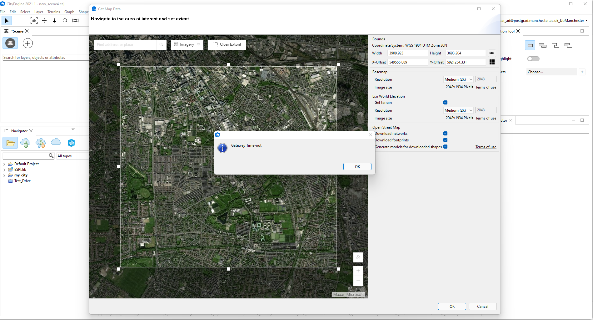

I'm trying to learn to use cityengine, but every time I try to download map data I get a gateway timeout error.

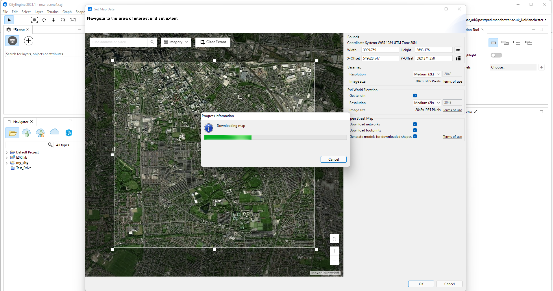

I sign in successfully, the get map data window pops up correctly, I set extent successfully and click okay. The progress bar appears and works through 'downloading elevation data', then stops at 'downloading map' around 1/3 of the way through, before throwing the error 'gateway timeout'.
I tried reinstalling, connecting through a VPN, restarting my PC, but nothing works.
Here's a screenshot of before the error appears, then the error itself:
Please let me know if there's a way to avoid this, hopefully it's just some small detail I missed.

This happens when the OSM server is down. Unfortunately from a CityEngine side, we cant do anything about this (except maybe improve our error message).
The only solution is to try again later or check your internet connection and that there are no firewalls blocking anything (although in your case, Im sure you don't have any of that, as it usually works).

Thanks @TaishaFabricius for the quick response!  It doesn't seem to be happening when the OSM server is down, I do check this page Platform Status - OpenStreetMap Wiki. Also we are getting this message when OSM data is not checked so this it should not happen?  I wonder, does the Get Map Data tool check OSM regardless of whether the user has checked the OSM boxes?   When I have received this message, I will go back (because the tool just closes rather than stays open) and un-check the OSM download and I will still get this gateway timeout message.
