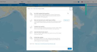

2. First you will see this what's new message. Please take a moment to read through these notes.
What's new in June 2023 release

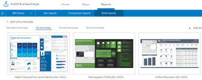

9. If you go to the Build Reports or Build Infographics workflows, you will see your templates are now migrated and contain (Esri 2023) in the names.
My templates gallery
