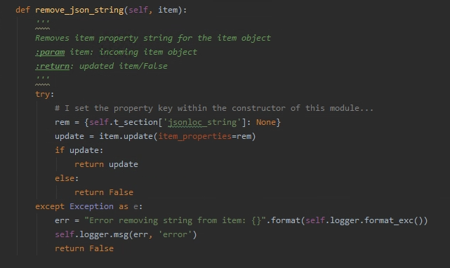

I'm building a test script that will change an item's property value (accessInformation), and then reset that property back to no value (Null) in the ArcGIS API for Python. I've tried passing None/False into the dict to update with no luck. Even a empty string would be favorable then my current workaround ("Null")

I noticed that None or empty string doesn't make any changes to the item when updated as well. I think is due REST api behavior which has a parameter to set when clearing fields is applied (clearEmptyFields) and I cannot find that from the Python API.
I gave it a go and tried if I can get the removing values working and it looks like following actually works. It will use the update endpoint and set description to empty.
