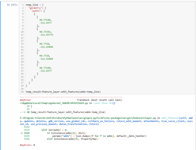

GIS_utahDEM
This is what I get:
EarlMedina
Remember it's expecting a list so it has to be adds=[temp_line]
