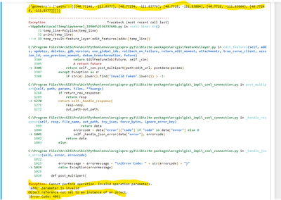

@EarlMedina I replaced adds=temp_line with adds=[temp_line] and this is what I got (sorry for the atrocious highlighting). I also printed temp_line just to see what it looked like:
