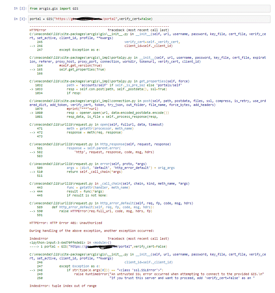

I am new to this API, I tried it with ArcGIS Online it works fine. But when I try to connect to our local ArcGIS portal, it doesn't work. Can anybody kindly point me to the right direction? I highly suspect that the problem is the API can't pick up my windows credentials which is required to login the portal.
More information:
Our portal is using IWA authentication, and this document for IWA points to not using a username or password:
It looks like there are some additional requirements for using IWA and the ArcGIS Python API:
"If your portal is configured to pick up your Windows credeintials using NTLM or Kerberos, you can omit passing in the username and password. The ArcGIS Python API is able to figure out when the GIS is using Windows authentication and picks the login credentials from the currently running process providing a seamless and secure login experience. Windows authentication only works on the Windows OS and requires pywin32 and kerberos-sspi python packages."
Please see the screen dump for details: (click to zoom in)

Hello Rohit,
Thank you so much for your reply.
I tested as you suggested, but the problem remains. I double checked with the administrator, we are using IWA, not SAML.
I not only tested in Jupyter notebook, I also tried in python IDE (Wing IDE) to make direct connections to the portal, but it was not successful.
Surely there is something wrong on our server, just don't know where to look at. I checked it with this document, Use Integrated Windows Authentication with your portal—Portal for ArcGIS (10.5.x) | ArcGIS Enterpris... , nothing looks suspicious in the server settings.
Update:  I just tried the python window in ArcGIS Pro, I can login our portal from there omitting the username and password ---- and I print out the user information, it seems the API picked up my windows login inside of ArcGIS Pro. Python window in Pro is not the ideal environment for me to do my tasks.
