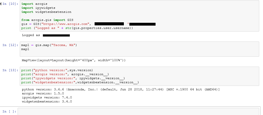

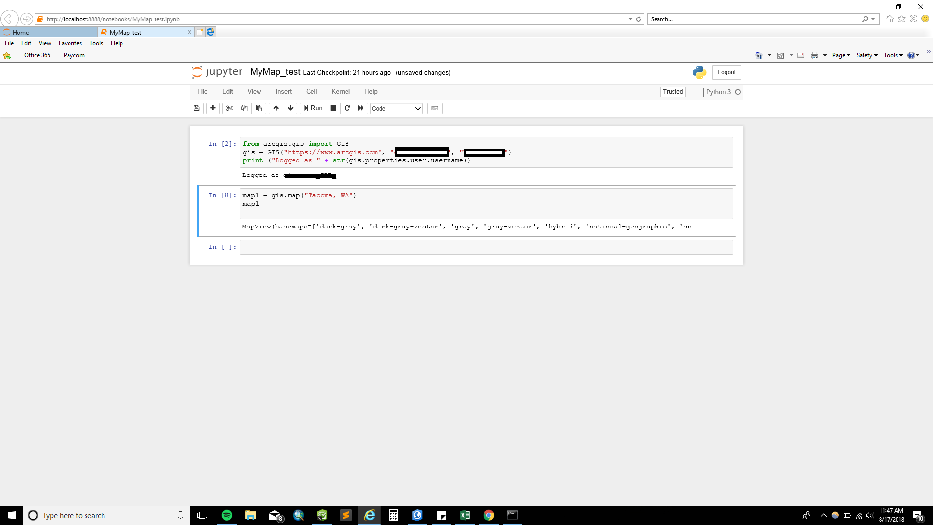

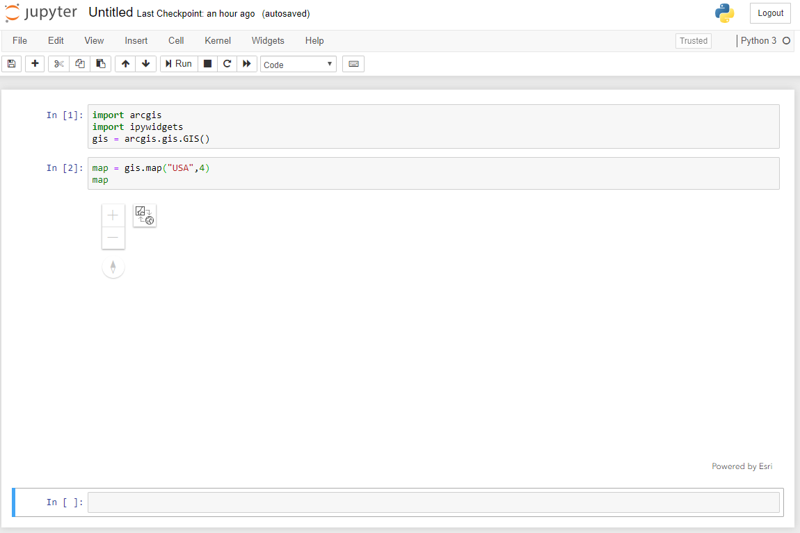

Hello,
I am just trying to render a map on my jupyter notebook and it is not displaying. What am I doing wrong here? For this example I am my using my organizations account to log into AGOL  because i plan to use some layers.
Python API Troubleshoot
Thanks

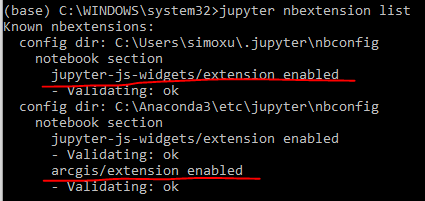

Hello so I checked for the extensions on my jupyter nb and got this nbextension

I also here are the module versions

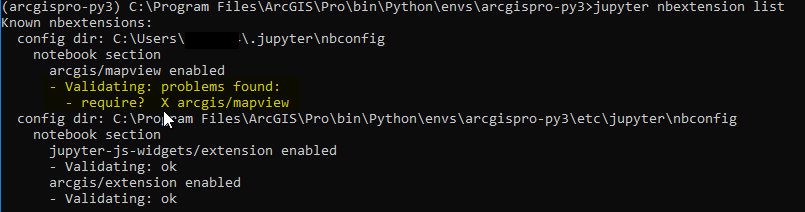

It seems you installed ArcGIS Python API 1.5.0 on the copy of the ArcGIS Pro python environment.
Something went wrong when you were upgrading the pre-installed Python API to the lastest version 1.5.0. and the problem you have in the arcgis/mapview validation is an indication that the old Python API was not fully removed or it's only the configuration not updated properly.
What you can do, at least give it a try at the moment is:
Remove the arcgis/mapview extension entry in the  <your user home folder>\.jupyter\nbconfig, then restart the Jupyter server and see if it works.

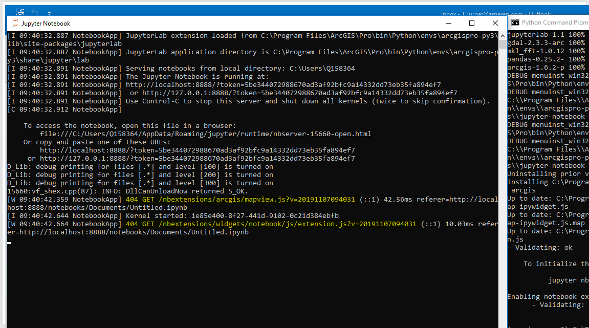

The web server window references to files that don't exist in my directory structure, giving 404 errors:
I have tried all suggestions in the previous posts, including the uninstall and re-install of the arcgis package with conda.  Those files just aren't there.  I found an extension.js file in another folder:
C:\Program Files\ArcGIS\Pro\bin\Python\envs\arcgispro-py3\share\jupyter\nbextensions\jupyter-js-widgets
I tried making the ..\widgets\notebook\js folder and copying it in - it removed that particular error message, but didn't seem to solve any problem.  And, just putting it there willy-nilly, I don't know if that might actually lead to other problems, so I removed it.
I can find no mapview.js file anywhere in the entire installation.  Is that supposed to install with the arcgis package?

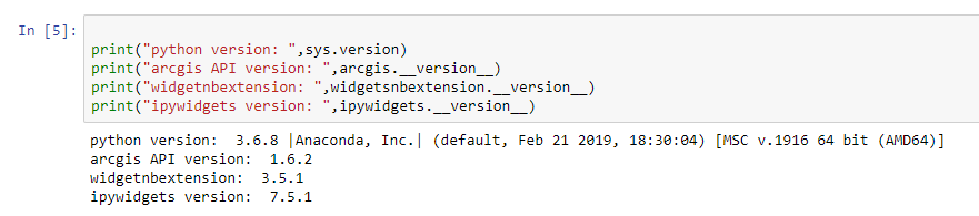

For kicks, here are my install versions.  Though, I'm unsure as to whether ipywidgets or widgetnbextenion even relate to this issue.
I also have the same arcgis/mapview problems message that Gina Fonseca was showing
