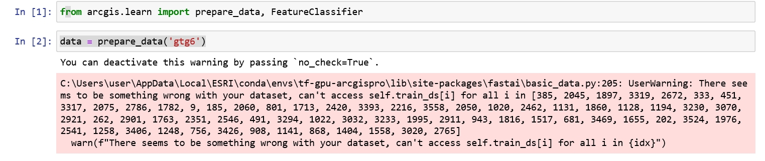

I'm trying to prepare training data with this detail :
ArcGIS Pro 2.4.2
inRaster = "E:\Work\ArcDL\Base\MANADO_FIX.tif" (raster 8bit unsigned, thematic, with nodata=0)
out_folder = "E:\Work\ArcDL\gtg6"
in_training = "E:\Work\ArcDL\Experiment_BuildFoot_2\MyProject\Shape\House.shp" (shp that has Classvalue, Classname, RED, GREEN, BLUE field)
image_chip_format = "TIFF"
tile_size_x = "256"
tile_size_y = "256"
stride_x="128"
stride_y="128"
output_nofeature_tiles="ONLY_TILES_WITH_FEATURES"
metadata_format="Labeled_Tiles"
start_index = 0
classvalue_field = "Classvalue"
buffer_radius = 1
in_mask_polygons = "E:\Work\ArcDL\Experiment_BuildFoot_2\MyProject\Shape\Mask.shp"
rotation_angle = 0
I run my prepare data syntax just like this :
data = prepare_data('gtg6')
But I always ended up in this kind of error for labeled_tiles metadata format, there's no further explanation and I cant use the data for training since data.show_batch() will result in OSError: -2
Any solution?
Thanks in advance.

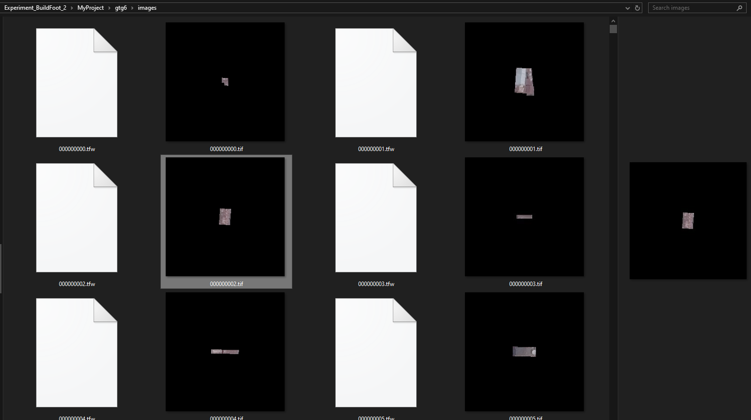

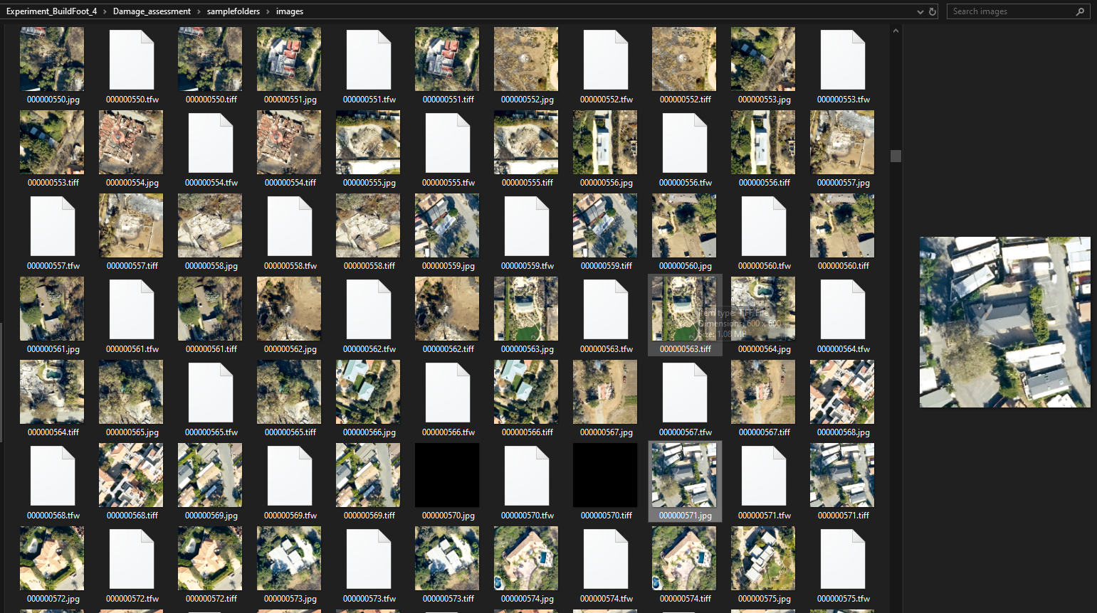

Big_DataManado
Thank you.., I set my cell size to 0.3, and this is my screenshot at my exported files :

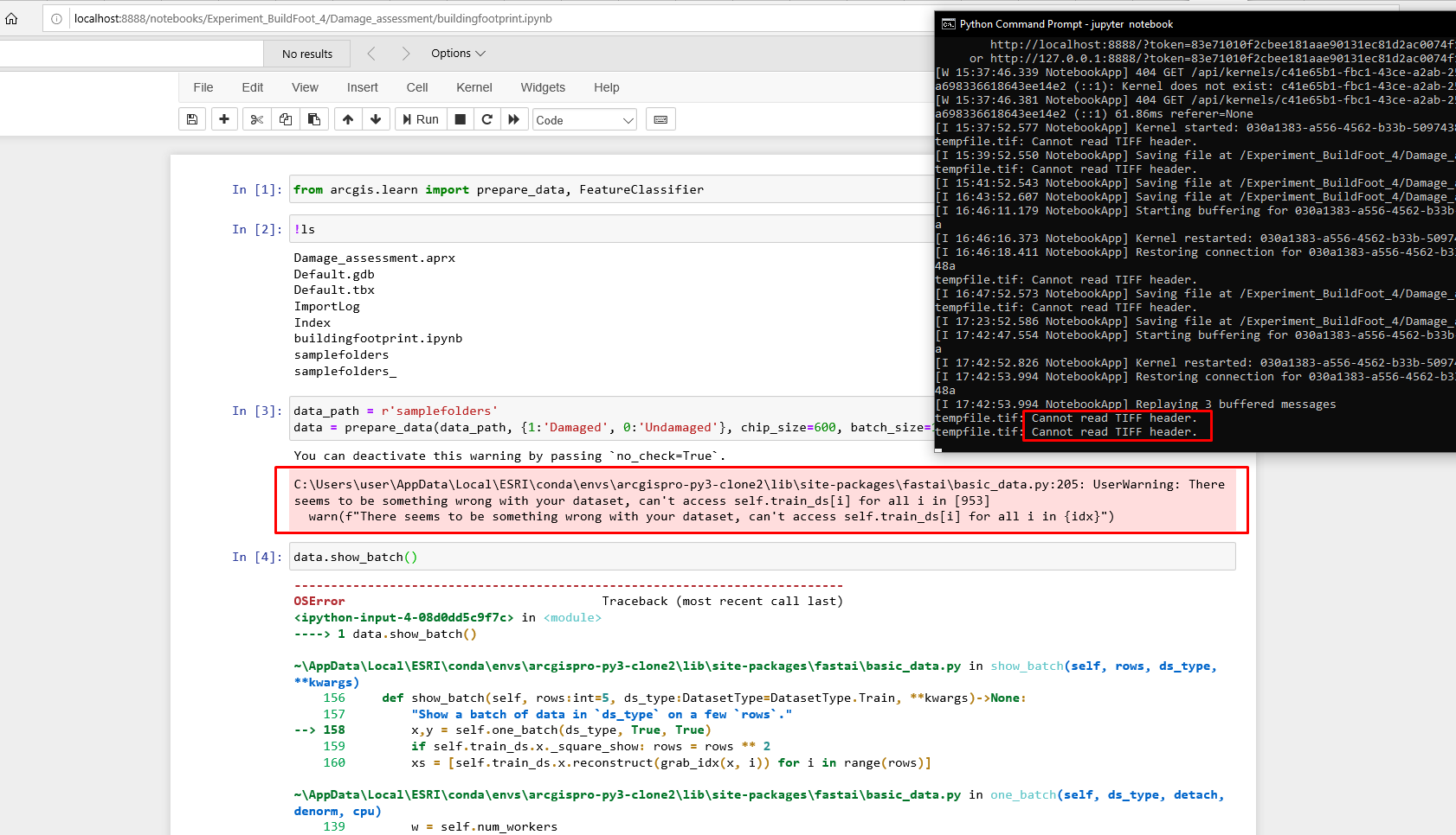

Because I did this based on tutorial Feature Categorization using Satellite Imagery and Deep Learning | ArcGIS for Developers  then I try to implement that tutorial using the same data based on that tutorial (with cell size 0.1) and this is my screen shot at my exported tiles based on the tutorial :

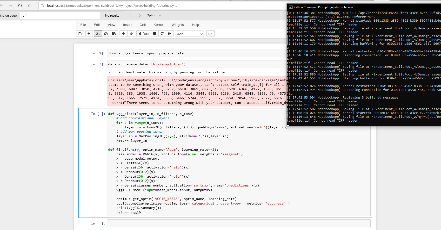

but it still have the same error and in jupyter notebook it says Cannot read TIFF header :
anything wrong?
thanks in advance

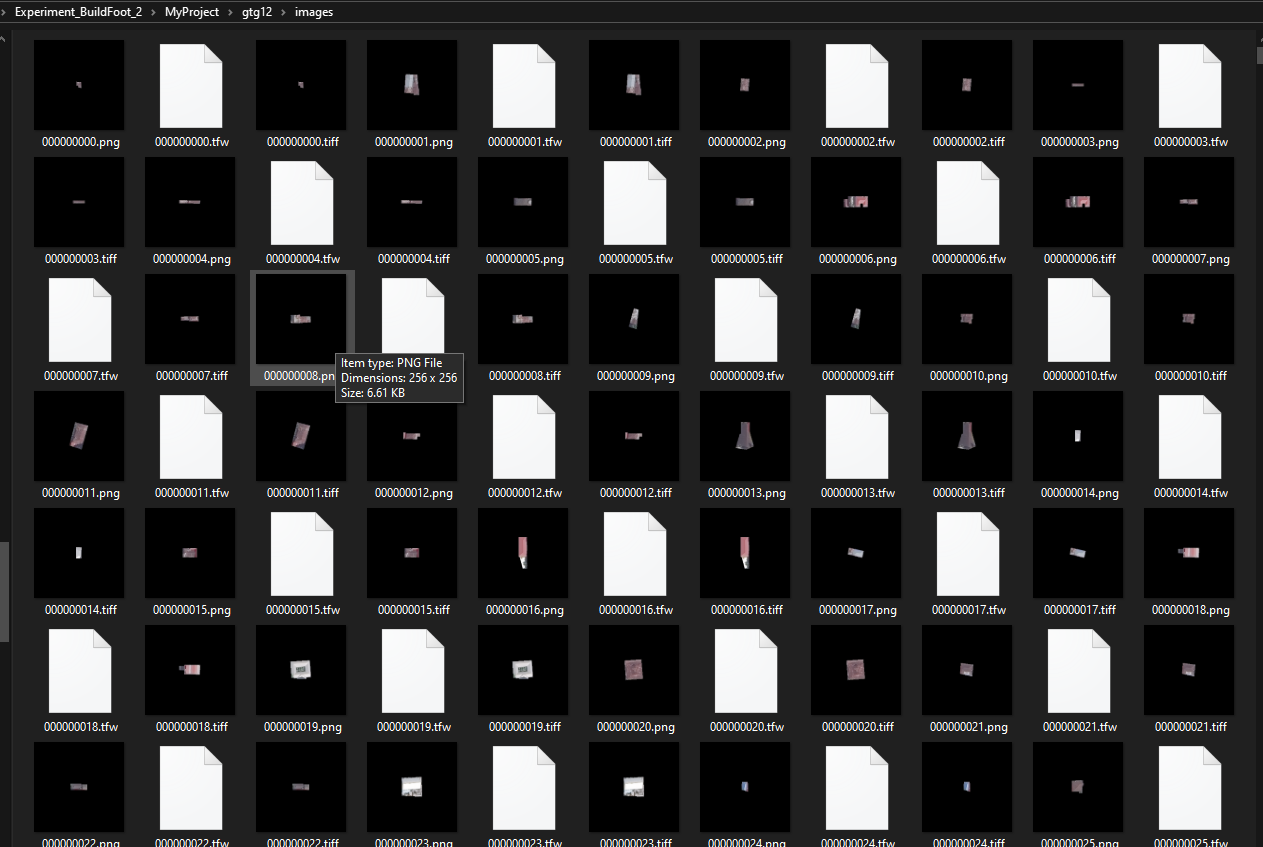

Big_DataManado
I did have... and no, it not working (I also test JPEG) :

I can see .tiff as well as .png files in this folder, can you try exporting your data to a new folder ?
Big_DataManado
I use different folder name (you can check at my previous I use "gtg6" for tiff and "gtg12" for png) but however the tiff always follow along... is there something wrong?

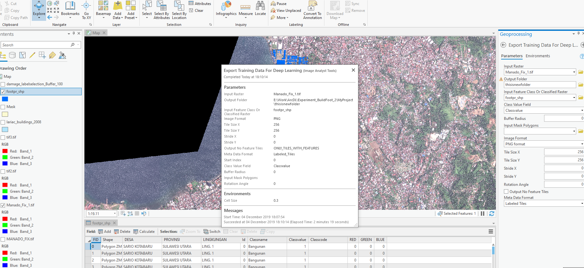

Here's the result :
I always exported to new folder since ArcgisPro won't allow if the output folder already exist.

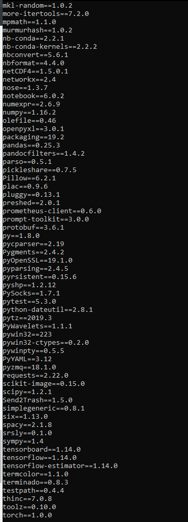

Here's my environment :
and my ArcGIS Pro version
