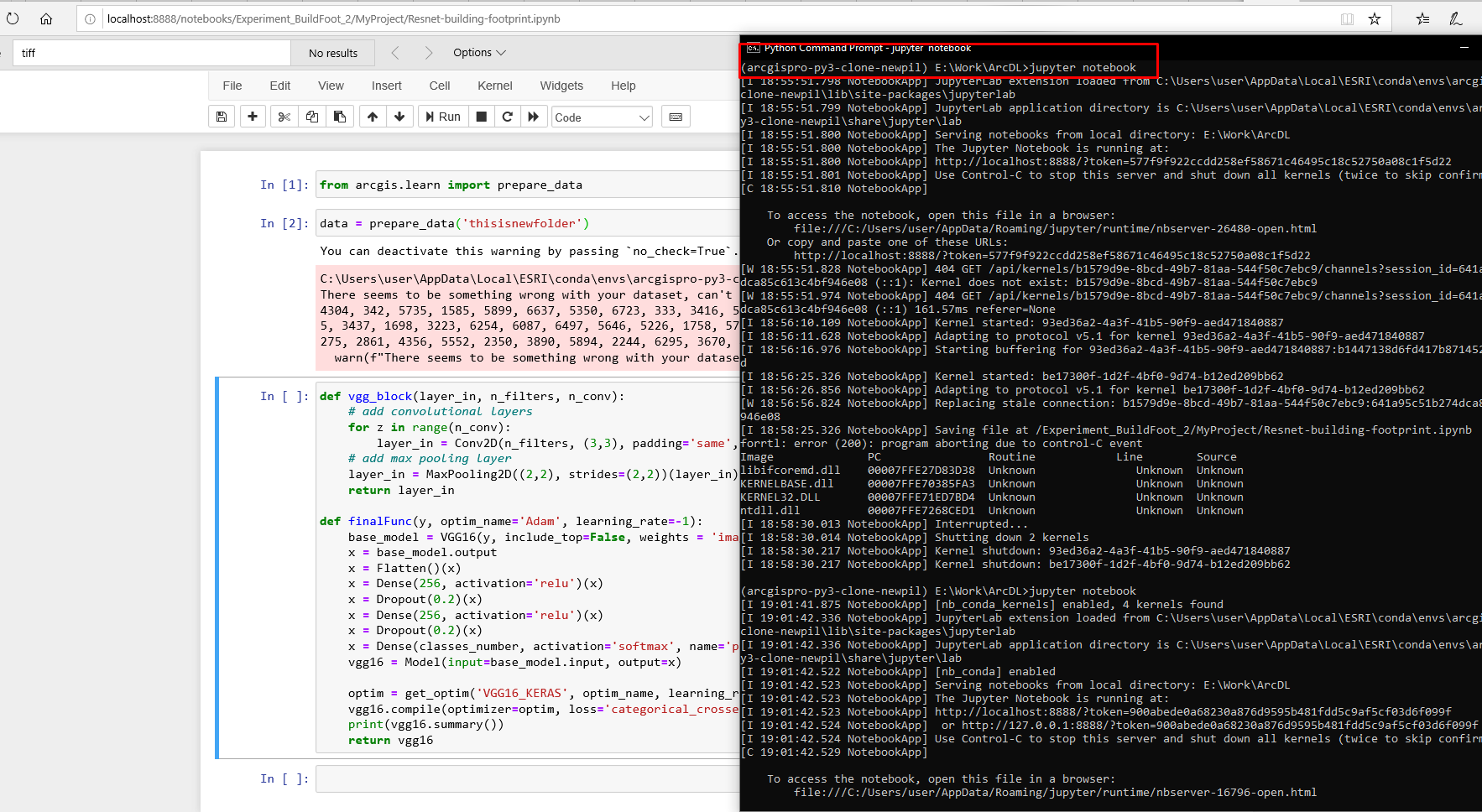

I'm trying to prepare training data with this detail :
ArcGIS Pro 2.4.2
inRaster = "E:\Work\ArcDL\Base\MANADO_FIX.tif" (raster 8bit unsigned, thematic, with nodata=0)
out_folder = "E:\Work\ArcDL\gtg6"
in_training = "E:\Work\ArcDL\Experiment_BuildFoot_2\MyProject\Shape\House.shp" (shp that has Classvalue, Classname, RED, GREEN, BLUE field)
image_chip_format = "TIFF"
tile_size_x = "256"
tile_size_y = "256"
stride_x="128"
stride_y="128"
output_nofeature_tiles="ONLY_TILES_WITH_FEATURES"
metadata_format="Labeled_Tiles"
start_index = 0
classvalue_field = "Classvalue"
buffer_radius = 1
in_mask_polygons = "E:\Work\ArcDL\Experiment_BuildFoot_2\MyProject\Shape\Mask.shp"
rotation_angle = 0
I run my prepare data syntax just like this :
data = prepare_data('gtg6')
But I always ended up in this kind of error for labeled_tiles metadata format, there's no further explanation and I cant use the data for training since data.show_batch() will result in OSError: -2
Any solution?
Thanks in advance.

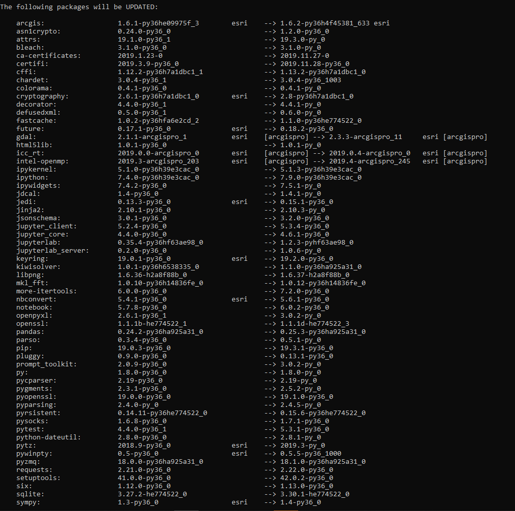

it seems the pillow were installed by command above using conda install, and this is what changed :
anything wrong with my setup or I missed something?
Thanks in advance.

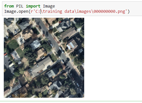

To verify your pillow installation try to load an exported image chip directly using the following code
from PIL import Image
Image.open(image_path)
it should give a similar output as below

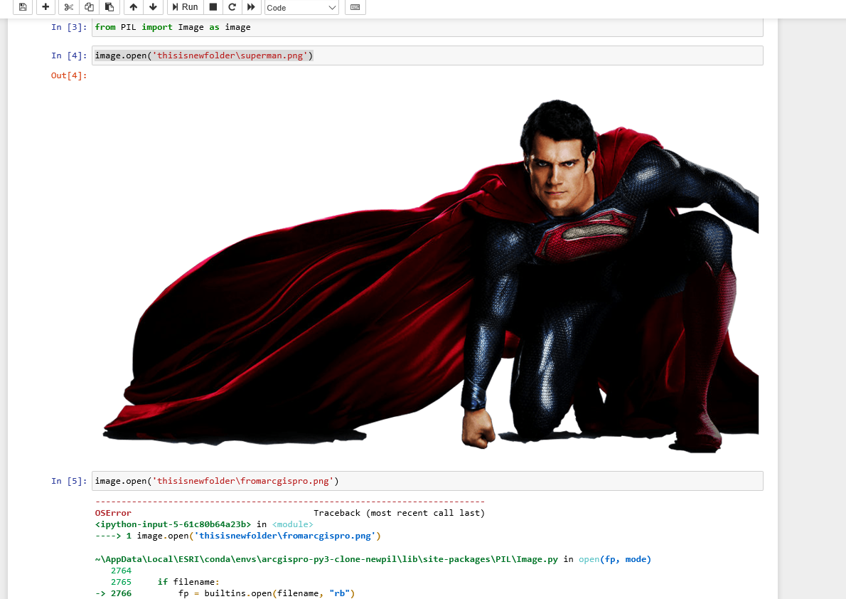

Big_DataManado
Now it seems to make sense, it resulted in an error :
so what should I do ? in another side I need this conda install -c pytorch -c fastai fastai=1.0.39 pytorch=1.0.0 torchvision command to prepare_data()
Big_DataManado
One more thing, it can read normal image png, but it won't work from image created from export training data

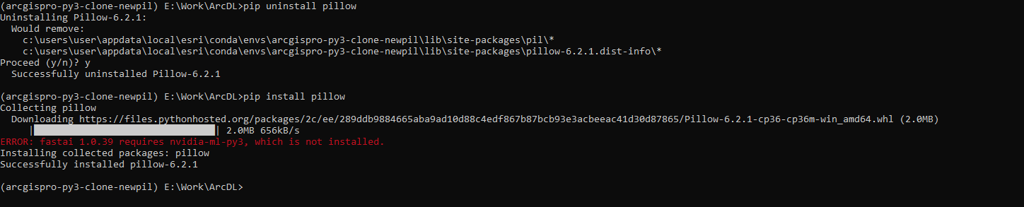

Can you uninstall pillow
pip uninstall pillow
and then install it again using
pip install pillow
If still you are not able to read the image please attach the image here.
