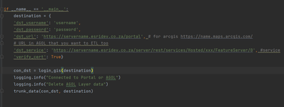

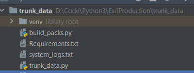

I have added a script to delete data, I usually break it up into packs of 2000, queries are very dependent on network performance. Just unzip the scripts into a python project an install ArcGIS for python pip install arcgis the script you want to fill in is trunk_data.py
then on line 42 fill in your server details  and point to the service

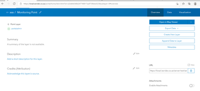

in agol you can get the service url details if you navigate to overview then url, you add /0 if there is only one service /1, /2 for the next etc.
