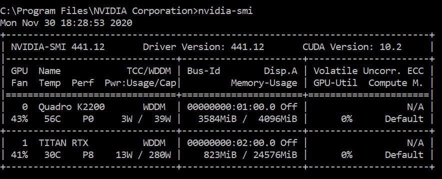

I have my GPUs configured as follows:

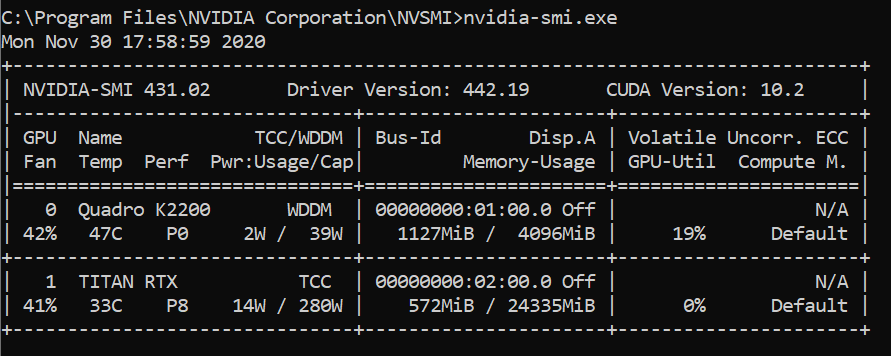

As you can see, both in WDDM mode and both with ECC mode disabled. I have also tried setting the #1 Titan RTX to TCC mode, instead of WDDM:
With this last configuration, same error.
