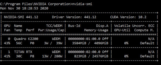

I have my GPUs configured as follows:
As you can see, both in WDDM mode and both with ECC mode disabled. I have also tried setting the #1 Titan RTX to TCC mode, instead of WDDM:
With this last configuration, same error.

Ok, I reply to myself:
Seems to be a problem when you specify the GPU number in Pro and you have set the environmental variable CUDA_VISIBLE_DEVICES
Some time ago I used the command Viewshed2 that uses CUDA processing for speeding up the visibility calculations using full geodetic solution. For harnessing the power of one of my GPUs I set the env CUDA_VISIBLE_DEVICES=0
This env variable seems to override whatever GPU you indicate in the Pro GUI, so if you have several GPUs on your system don't forget to leave the GPU number in Pro always as 0, and use the CUDA_VISIBLE_DEVICES variable to point to the GPU that you want to use. At least this has solved the issue for me.
Prior to this, I double checked that my CUDA drivers were properly installed, that the bandwith with my GPU was healthy, and so on. This is so complex but it works.
