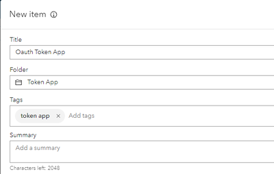

Hi @CarlVricella,
You can use an Oauth2.0 Application to generate your token:
1.  In ArcGIS Online go to Content > New Item > Application
2.  Other application > Next
3.  Specify a Title and Tags and click Save
4.  In the Items Details of the new application, click the Settings tab

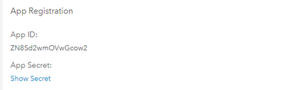

5.  Scroll down and click Registered Info
6.  Copy the App ID and App Secret
7.  You can then use this to generate a token:
import requests, json
# Generate Token
try:
    params = {
        'client_id': clientId,
        'client_secret': clientSecret,
        'grant_type': "client_credentials",
    request = requests.get('https://www.arcgis.com/sharing/oauth2/token', params=params)
    response = request.json()
    token = response["access_token"]
except Exception as e:
    errorLog("Error generating token", e)
CarlVricella
Ah cool, so if I do it like this even if the password expires on the account that registered the application I can still generate the access token indefinitely?
JakeSkinner
Esri Esteemed Contributor
Correct, the expiration of the application owner's password should not interfere.
