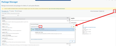

I recently installed ArcGIS Pro 3.1.0 and in the Package Manager I do not see the argis package? I wanted to see what version is installed and I'm not seeing it (screenshot attached)? I've searched and nothing shows in the search? I'm still very much learning on the API but this seemed odd.

Same with me - I had Pro 3.1.2 installed, but the Package Manager was not showing arcgis or arcpy under Installed packages.
I resolved it by simply clicking on refresh button (Refresh metadata for all packages) within Environment Manager of an Active Environment!
