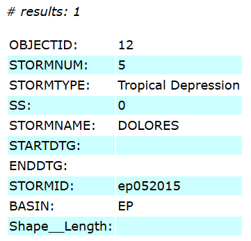

OK, so we discovered that the code is actually correct, but the backend service has data integrity errors. Which is unfortunate.  There is a record that does not have a geometry value, that causes errors.
I tested a couple of the other layers coming from this service, and found a similar issue. However, I tested layers from https://services9.arcgis.com/RHVPKKiFTONKtxq3/arcgis/rest/services/Active_Hurricanes_v1/FeatureServe... and it works fine. I hope this helps someone else who might stumble upon this. Maybe the data will get fixed in the "Active_Hurricanes_Sampler" service.  For now I just plan to query out the Null records.
