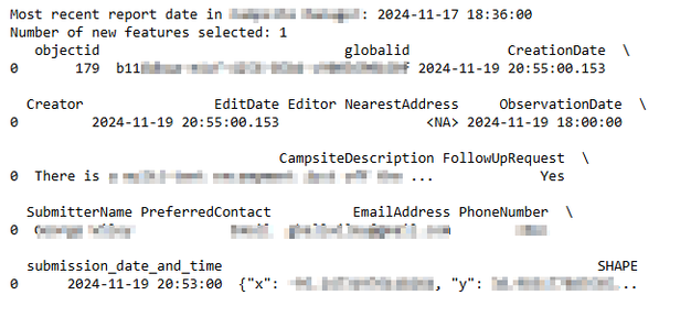

I think line 10 is working because I added a print statement for the sdf variable and got this (confidential information blurred in the screenshot):
