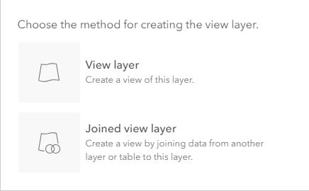

Is it possible to use the python Api to create a joined view layer? I have checked the reference guide and saw the join analysis tool, but it didn't appear to have a parameter for output type like using the tool in the classic map viewer has. I also see the function for creating a view, but nothing associated about joins. If it is not possible with the python Api are there alternative methods to programmatically create joined view layers?
