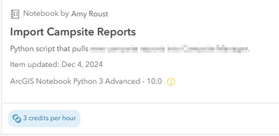

@AmyRoust I see your importing arcpy.  Are you using an Advanced runtime in AGOL Notebooks?
AmyRoust
Good question! I believe I am:
