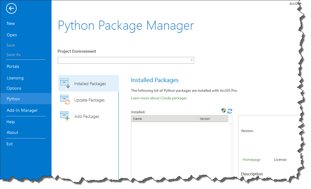

I also notice my Pro 1.4.1 is missing a python environment? Is this due to me doing this on a machine that also has Conda?

  4. In general if you are using conda it is preferable to create a new environment for each project that you are working on. Note, Pro's ArcPy works best in the built-in `arcgispro-py3` environment.
  5. I will pass along that missing environment issue to the appropriate team in ArcGIS Desktop.
