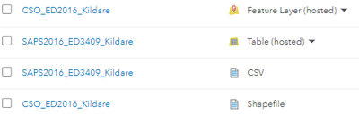

We used the ContentManager add() method to add these items, you can find more information about this method here.
Publish the Shapefile Item as a Feature Service.
## publish hosted feature service
shp_fs = shp_agol.publish()
Publish the CSV Item as a Hosted Table.
## publishing properties so csv is added as a table and not a spatial layer.
csv_properties = {
    "type:" : "csv",
    "locationType" : "none"
## publish hosted table
csv_ht = csv_agol.publish(publish_parameters=csv_properties)
We used the Item publish() method to publish our Hosted Services, more information on the publish() method can be found here.

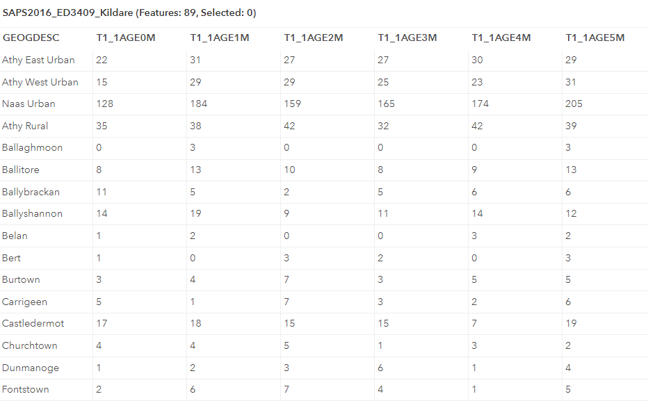

Check the Feature Service and see if the Table was added.
And check the Data tab to see that the fields have been added.
Notice that the data is missing. Essentially we have added the Table schema to our Feature Service. Next, we add/append the data from the original CSV.

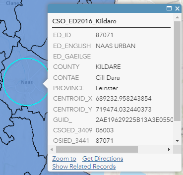

The cardinality is set as one-to-one, this means that each record in the spatial Feature Layer can have only one related record in the related Table. Setting the composite to True means each feature in the destination table is expected to be related to an origin feature.
Let's check that the relationship was created successfully. Open the data in a Map and click on a Polygon. The Popup Window should contain a link Show Related Data, click it.
Look at that!
