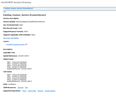

I've added a new feature layer to an existing feature service via the REST API (Add to Definition). The new feature layer gets added successfully and it is listed in the layers when viewing the service via the service URL. However, the layer does not appear in AGOL and I cannot access it.
I've tested it with several existing feature services in my agol, by adding the exact same layer definition to multiple feature services. Some of for some of them it works perfectly but for others I get the above behaviour.  I have even tried to duplicate one of the existing layers in the feature services where I see this issue with no success.
Has anyone experienced this or can provide any help? I am guessing that there is something different about the layers it does not work on.

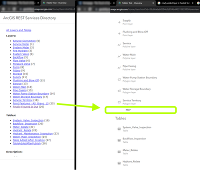

Edit: It seems to affect feature services originally published from Arcgis Pro
Example:
Point Layer 2 added via to existing layer via REST API. Visible at feature service URL but not showing up in AGOL

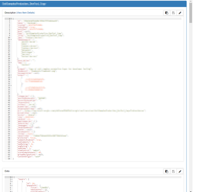

Ok, so I suspect this is related to feature services published from Arcgis Pro. If you view such the JSON for such a layer in AGOL assistant there is a "Data" page which specifies the layers. This does not seem to get updated when a new layer is added via the REST api.
When you compare a feature service created directly in AGOL versus one published from Pro this data page is not present, only the feature service description.

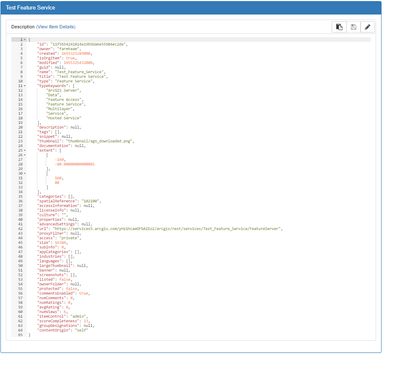

So, I edited the JSON on the data page in AGOL Assistant and just left an empty set of curly brackets and suddenly the layers I added via the REST api were visible in AGOL. This doesn't seem to have affect my existing data and the service seems to still work fine.
Feature service created via AGOL: Just one "Description Page"
Feature service created in Pro: Description page and Data page detail the layer
Edit made to the Data page:

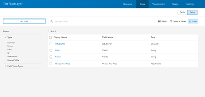

So for example, here is a simple point layer I created in AGOL. Create you own layer with the fields etc. that you need.

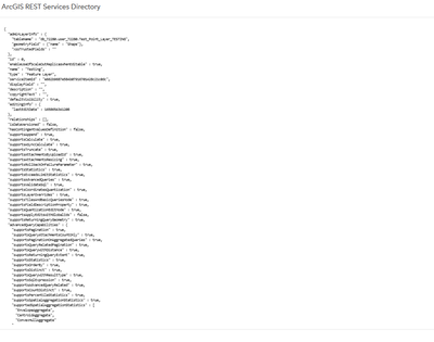

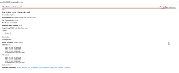

View the feature service in and switch to Admin mode (link in top right):
Open the layer you want to "copy" to your existing feature service and view and copy the raw json:
Edit the json:

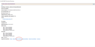

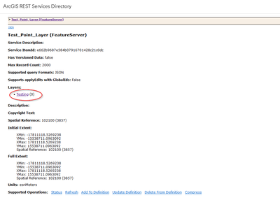

Add to your exsiting service layer. So here is a dummy one I set up:
Before

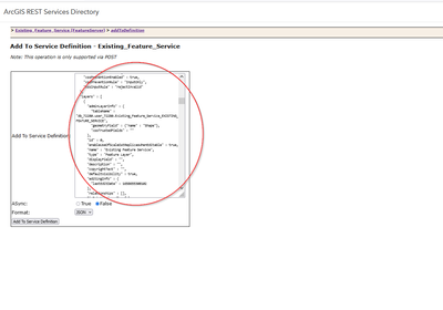

Add to Definition:
Remove the json already there and paste your edited json from above.

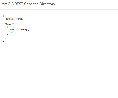

Paste in your edited json from above and you should see this response if successful:

{  "layers" : [
  "adminLayerInfo" : {
    "tableName" : "db_72280.user_72280.Test_Point_Layer_TESTING",
    "geometryField" : {"name" : "Shape"},
    "xssTrustedFields" : ""
Before
Add to Definition:
