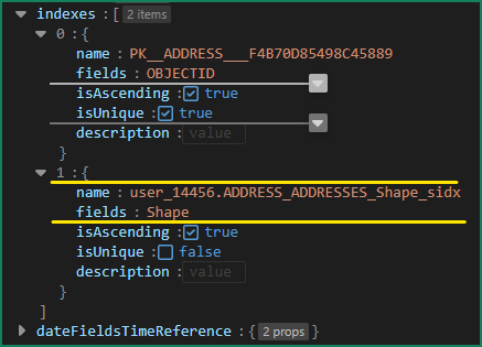

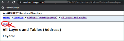

This information is both critical and non-obvious. The answer lies in the query the browser makes just prior to the "updateDefinition" POST request, which is a simple json request of the hosted feature layer. anyone may do the same by navigating to the REST endpoint, click on either the sublayer of interest or on 'All Layers and Tables' , then click on the JSON hyperlink in the top left:
The JSON will give you slightly more information than the HTML view.
(Optional) copy and paste the JSON into https://jsoneditoronline.org/ to make working with it easier
scroll down to 'Layers'
open the associated sublayer, likely index number 0
scroll down to 'indexes'
here you will find all the registered indexes for your feature class.
one of them will have the  value 'Shape' for the fields attribute. This is your spatial index. the value of the name attribute is what you are looking for.
hence, my updateDefinition POST request would have the payload  {"indexes":[{"name":"user_14456.ADDRESS_ADDRESSES_Shape_sidx","fields":"Shape"}]}
