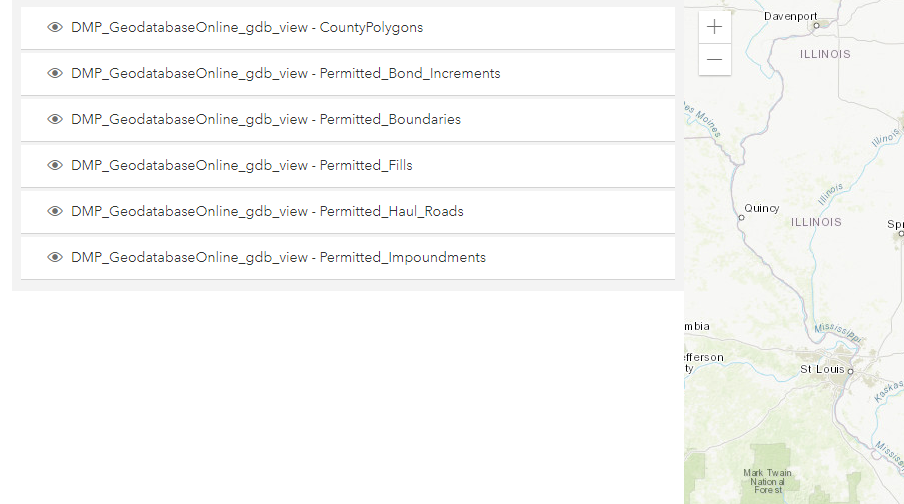

I would like to display layers on a side bar but layer options do not appear. The eye sign is visible and working fine but options not.
Do you have any idea what I am doing wrong?

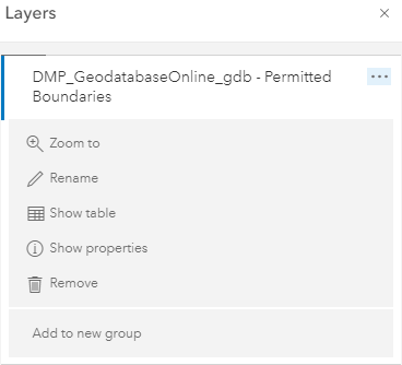

Thank you! I was able to add actions. Now, I am trying to customize them. I would like to come something like this
Is there a source showing all available action ids/classes.
