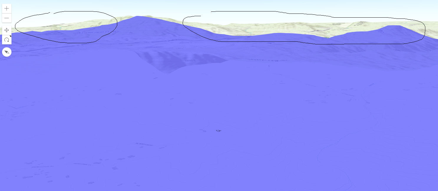

I created a simple code with example WMS Layer on the Scene View with the ground elevation.
Codepen: https://codepen.io/tomaszbarczyk/pen/VwYQRVN?editors=1000
I observed that at certain map tilt WMS Layer is not covering the whole visible area whereas it should. Actually WMS layer should cover terrain selected on this screenshot:
Is there any option to fix that behaviour? Any changes in layer configuration are needed?

Hello Tomasz,
This is a know limitation for WMS and MapImageLayer. This visual limitations just happens if user tilt that the far away hills/mountains get seen.
Workaround: Set the tilt constraints to avoid that the user can tilt to this point where you can see this effect
SceneView | constraints
Example:
        var view = new SceneView({
          container: "viewDiv",
          map: map,
          constraints: {
            tilt: {
              max: 60
This technical limitation would be solved in the future.
