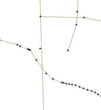

I was performing Service area analysis, but I am facing this problem, the buffer is getting created along only one street. So plz help me solve this problem.
Adding to this I am also facing another problem saying
Warning: Location Facilities" is on a non-traversable network element position.@
Your answer is in the error itself:  check the network connectivity of the line segment on which the facility has been placed.  It's probably not connected.  It appears to be on a freeway or some sort of limited access highway: when building a network, the underlying data on such features can be problematic.  Oneway values and connectivity issues will kill an analysis quicker than than anything else.

It is most likely the lack of connectivity. I'd run topology to see what is going on.
Also, another potential issue is it appears there are spaces in some of the folders and file names.  Use underscores or get rid of the spaces, otherwise processes may fail (and unfortunately in these cases there is no error message that directly refers to the spaces).

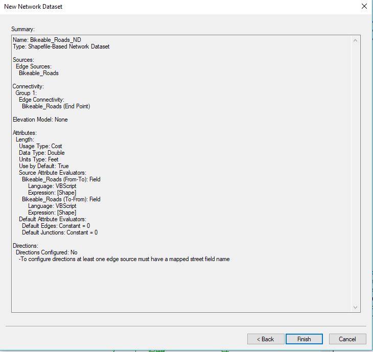

The reason you are getting a small polygon is because your facility is located on a non-traversable edge (as reported in the warning). THIS means that the edge on which you placed your facility is NOT connected to any other edge. So you are getting a buffer along the road edge on which you placed the facility. Reducing the number of edges will not do anything. You have to fix your data. Looking at the included picture I see the word "OSM". So I am assuming you are using Open Streetmap data. Did you create the network dataset with Anyvertex connectivity as OSM data is not the default edge connectivity?
I will suggest that you use the OSM toolbox to create the network dataset:
https://www.arcgis.com/home/item.html?id=4533407decd94428817a228cb36964cf
