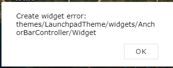

I took one of our dev WABs with custom widgets and updated the env.js file line #83 with your suggestion:
deployVersion = '2.19.20210709';
I added the Bookmarks widget to the WAB app, redeployed it and navigated to the app and this is what shows when it opens:
Inspecting the env.js that got loaded, line 83 shows the cached version not what I changed it to.
If I use incognito browser window (Chrome) it opens just fine with the Bookmarks widget!
