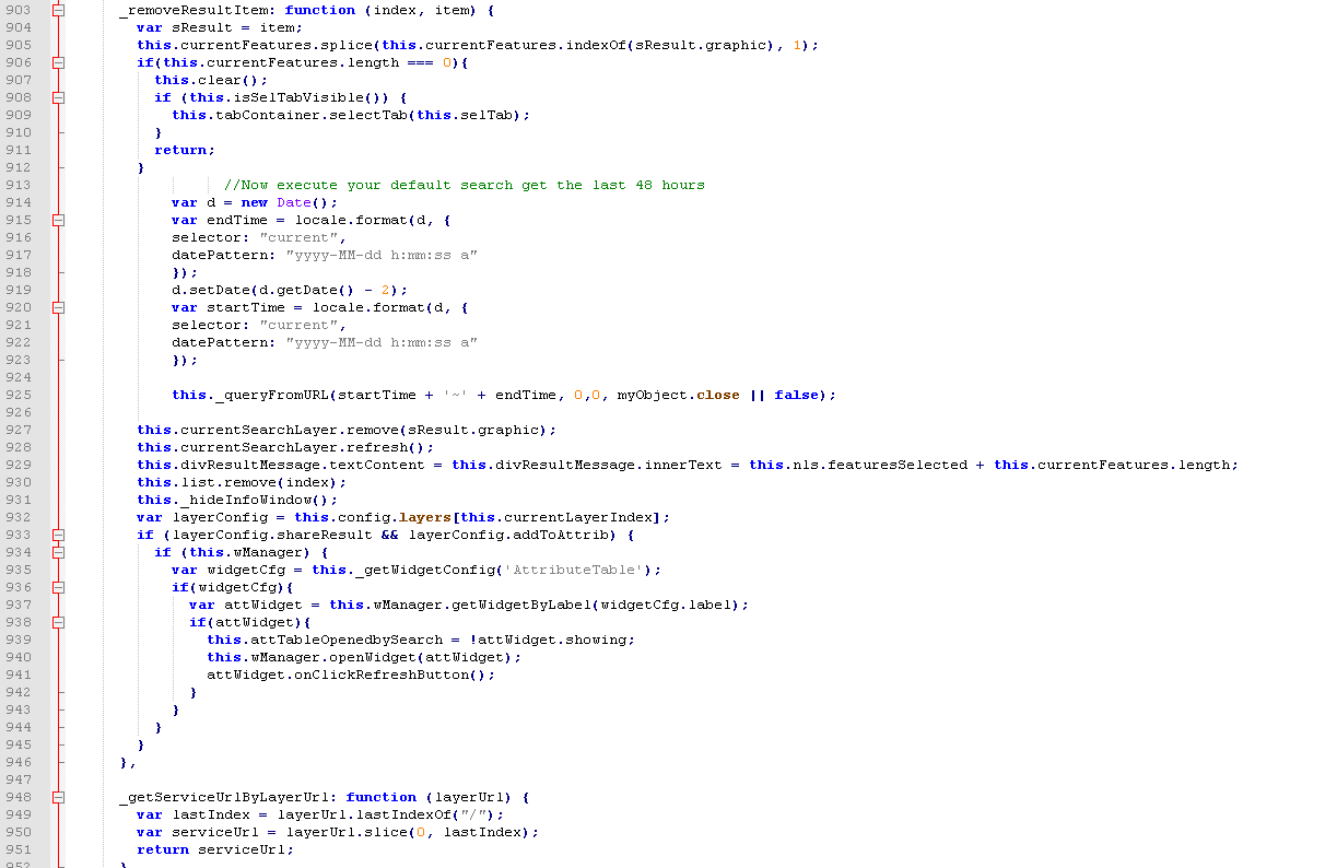

Is it possible to display the first couple of days of calls for service so that my users can see the last 48hrs by default? Then if they wanted to see something prior to that they can search for it using the filter. Currently, my users have to put in a date filter every time they open the application.

Thanks, I refreshed my browser and clicked on my widget and noting happened. I am sure that I am missing something silly here. I am a novice javascript developer.

Rudo,
actually the code above looks good but the placement does NOT. It looks like line 910 for you placed the code inside the _removeResultItem function. This is not the correct place for it. Remove that code from there an scroll up and fin the comment "//now check if there is a url search to do" and count that line and down 27 line. The next line after 27th should be: "if(this.serviceFailureNames.length > 0){". Right above "if(this.serviceFailureNames.length > 0){" is where you need to place the code. This is the issue with providing line numbers to code that on your end I am not sure what version or changes you have made.

Not providing the line number confused me a little. Would this help?

Rudo,
  Our line numbers are quite different. Where you need to add the code is NOT in the _removeResultItem function. It is in the _initLayerSelect function. Where you need to put it is before the line numbers you show above. What you need to do is search for this text "if(this.serviceFailureNames.length > 0){" it should only occur once in your code and you need to add the code we are talking about right above that line.

I believe I pasted the code in the right spot and still nothing happened.
