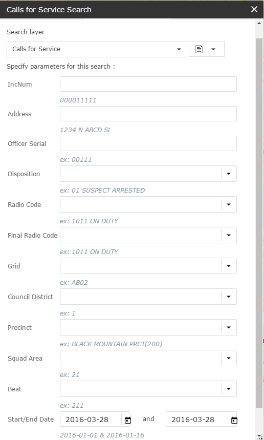

Is it possible to display the first couple of days of calls for service so that my users can see the last 48hrs by default? Then if they wanted to see something prior to that they can search for it using the filter. Currently, my users have to put in a date filter every time they open the application.

I have attached the config_Calls for Service Search.json and the widget is using one layer, that has 12 different filter options. The date range is the very last one?

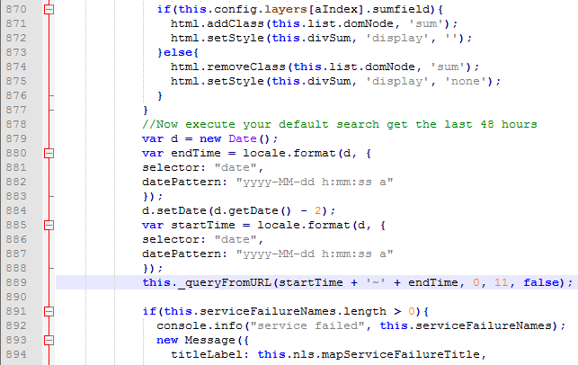

  So you could setup a second expression that only uses the date range then, and the use:
this._queryFromURL(startTime + "~" + endTime, 0, 1, false);
Or you could move the date range expression to the very first expression value instead of the last one.

Could I use this?
this._queryFromURL(startTime + "~" + endTime, 0, 11, false);
Will that make it look at the 12 fields (i.e. date range field)?
RobertScheitlin__GISP
MVP Emeritus
Rudo,
  No you are confusing expression values with expressions. When you configure a search layer you can have multiple expressions (or one as you have) and each expression can have multiple expression values (like you 12 expression values). The _queryFromURL function takes the parameters of search value, search layer #, expression #, close widget.
